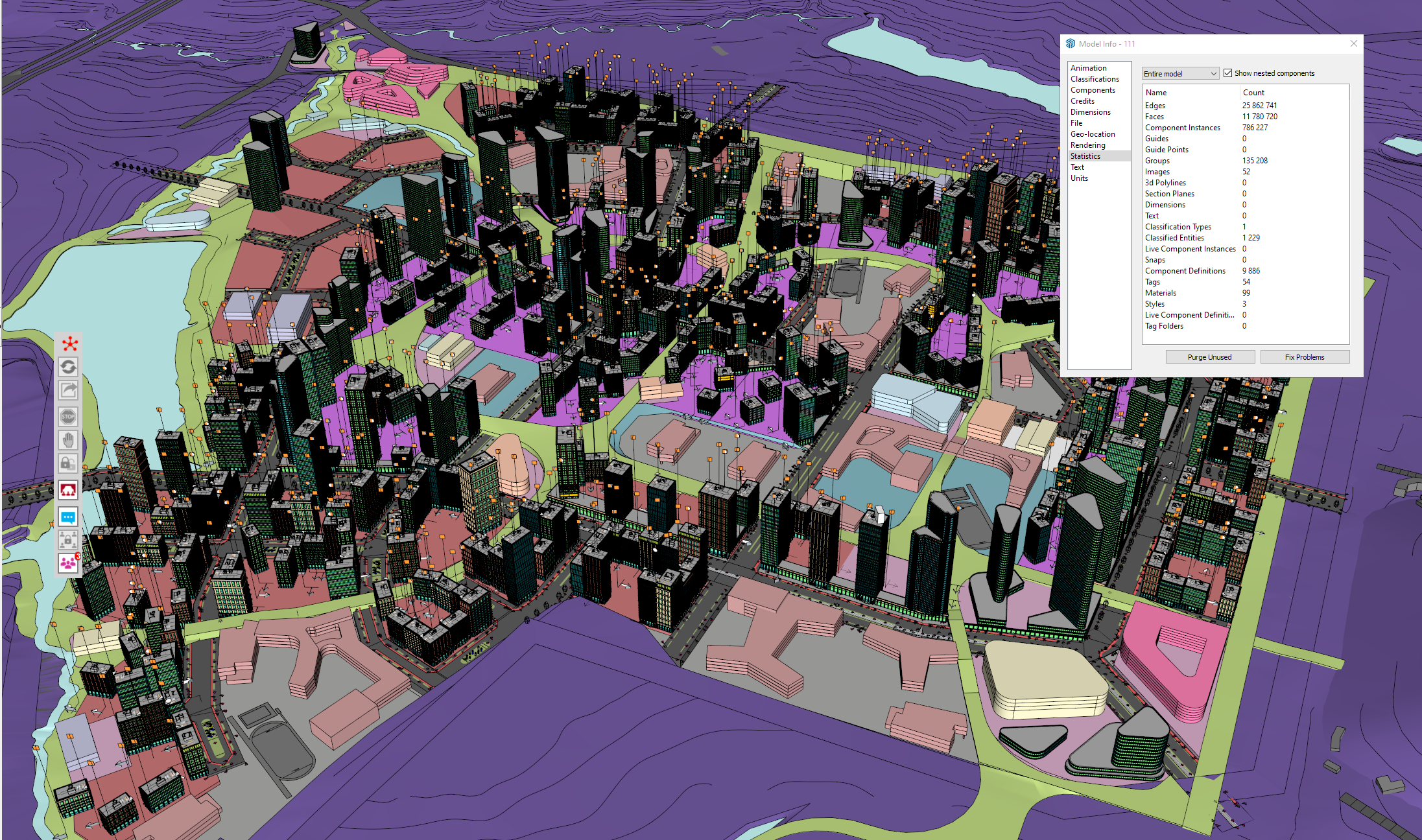

          Great work! For not large model work perfectly! But for big models (see attachment) unuseble, because too slow. Аннотация 2024-11-19 141452.png
          Sending changes - 5 minutes
          Receiving changes - 30 minutes
          Link to model:
          https://drive.google.com/file/d/1Lk5D2pn70A17AFaocPMWhC5-Oh9nTlNf/view?usp=sharing
          Sketchup 2023
          Windows 10
          RTX 2080 super 11 GB
          AMD Ryzen 9 5950X
          RAM 128 GB
