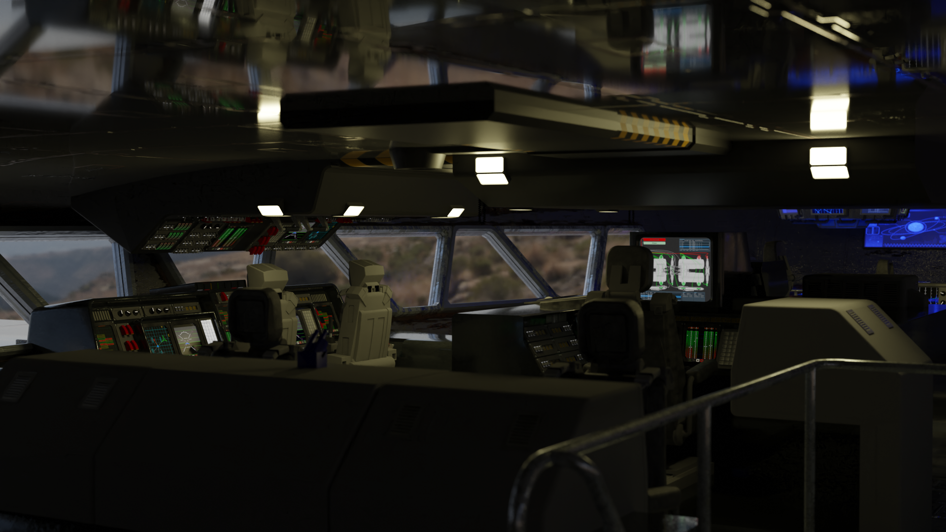

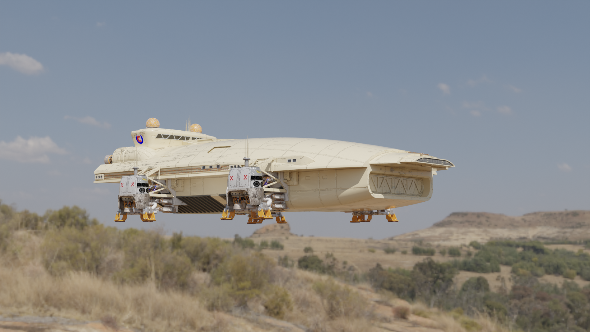

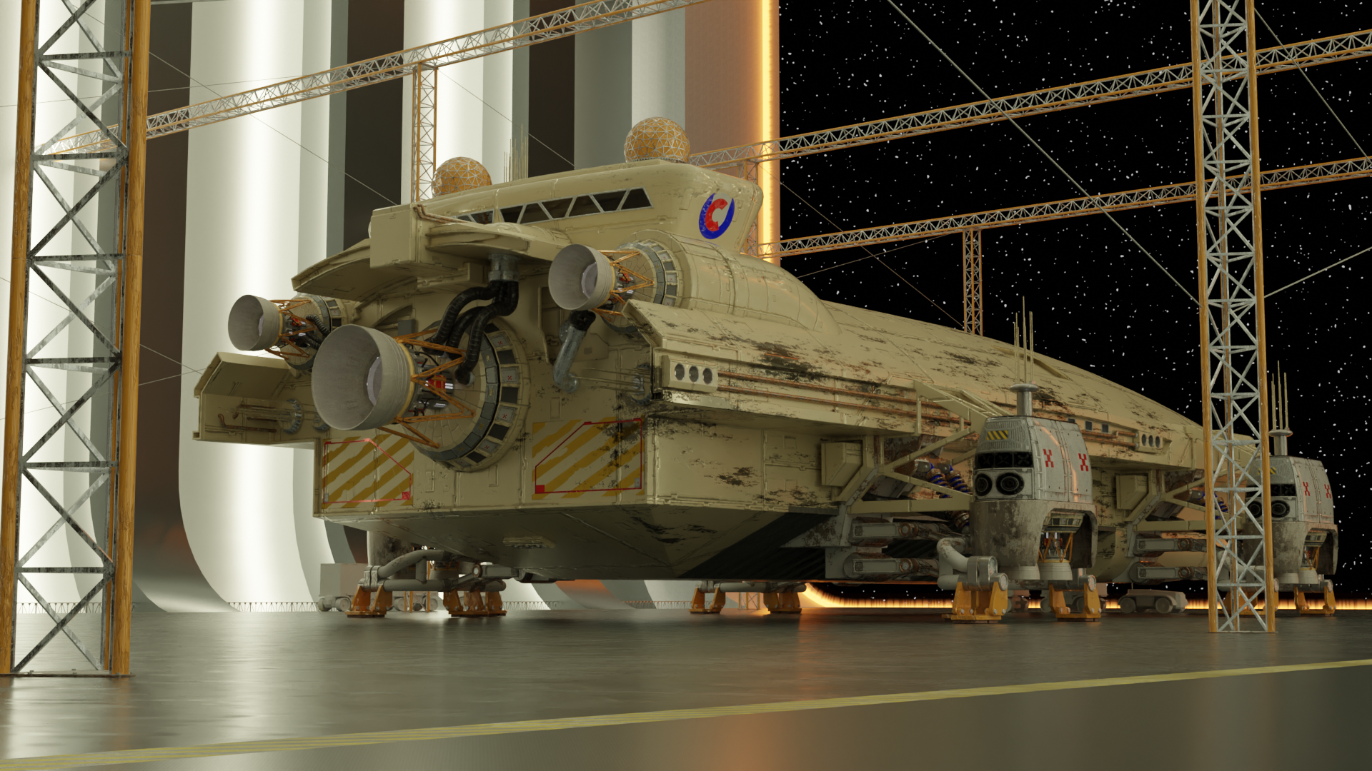

      So working on Importing SKPs into blender, The plugin that's available works great! I just cleaned up the shaders in blender after the import.
      Renders:
      Using these as possible assets in a short movie I've been working on since Vers 8.. πŸ™„

            Imported into Blender and used the Cycles renderer. Took some tinkering with the shaders and UV unwrapping to get this though. There is a real nice importer for SKP files, which means I don't have to export first.
