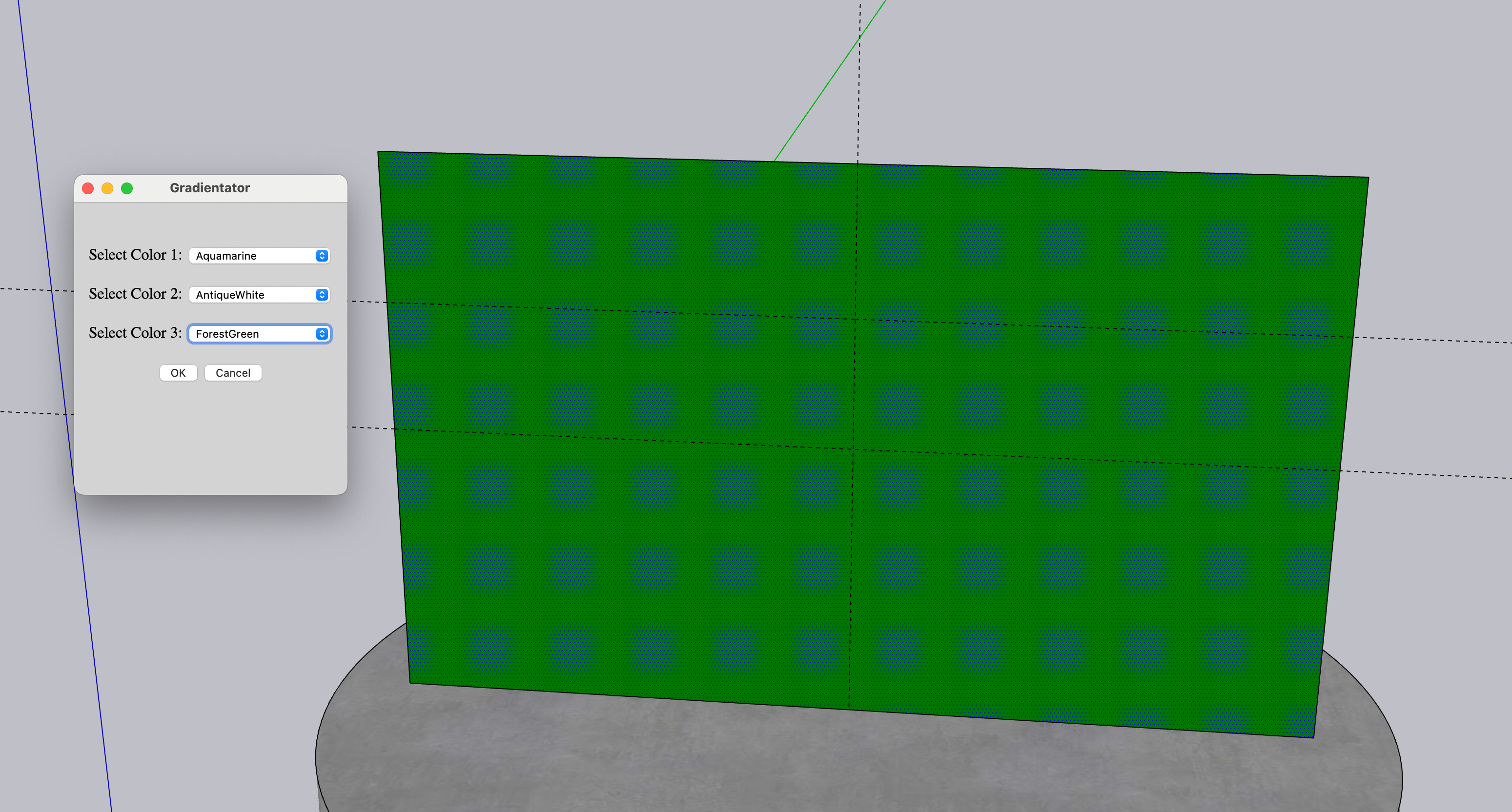

          So yeah, like I said, I had already read the posts about changing the "magical phrase". Problem is, no one explained how to find the plugins folder on a Mac (in the Library, but not following the pathways described at all). I ended up finding it, and changed the code with "TextEdit", saved the change, and reopened SKP again, but this is what I get, a one colour flat "gradient" (when I chose 3 colours - and before anyone asks, I had pressed "ok" to get the green colour, I only reselected the same colours agains because when you click "ok" the gradientator boxe dissapears):
          If anyone nows what's going on, I would greatly appreciate to know and how to fixe this.
          Many thanks !
