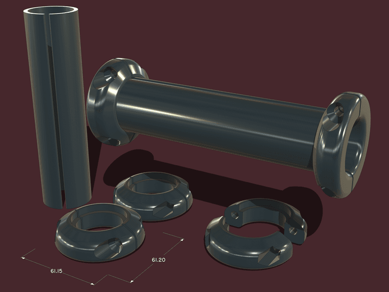

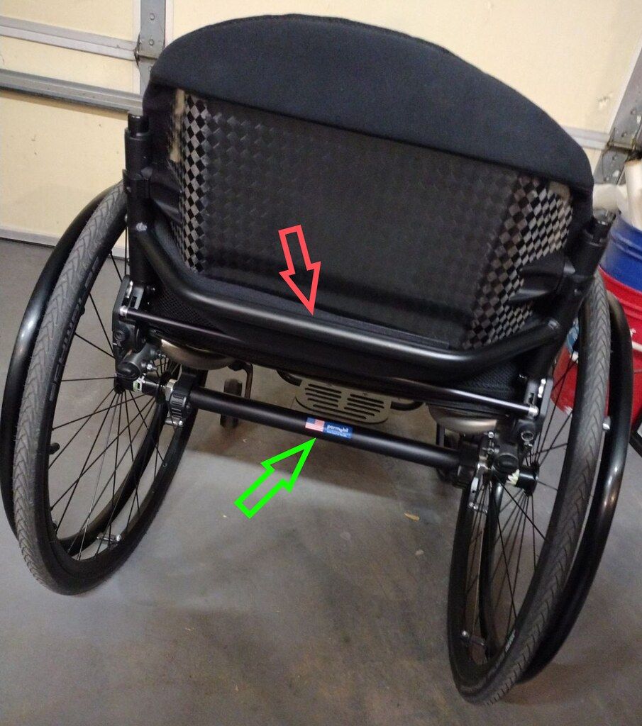

                        Another 3D printing project for a wheelchair. The tube was made of TPU and fits on the axle tube of a wheelchair to provide padding and protection from where a wheelchair lift picks the chair up. The rings clamp on either end of the tube and prevent the chair from shifting side to side. They were made of PETG.
                        The axle tube is indicated with the green arrow.
                          Is it to prevent wear and tear on the lift or to prevent the vehicle getting damaged?
                          Or is it a case that lift manufacturers and wheelchair manufacturers are not making compatible equipment?
                            It's to prevent wear and damage to the anodizing on the chair's axle tube. The lift is designed to be very generic and so it's not really an incompatibility thing. The lift is intended to pick the chair up by the 19mm aluminum cross tube on the backrest but that's not a real strong part to hang the entire weight of the chair from, especially on rough roads. I designed and printed some hooks to lift and support the weight of the chair by the axle tube. In the picture here https://flic.kr/p/2peh56W, there's some white foam tape that was used temporarily. It's not very durable, though.
