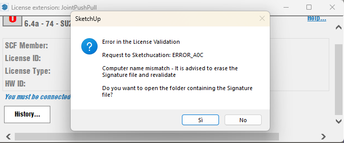

                          • C Offline
                            cirocire
                            Hi,
                            I don't know what happened, however, although I can see the licenses online, when I try to upload the license file, this happens (pls see attached image)
                            • TIGT Offline
                              Did you try doing the Signature file deletion that the dialog suggested and try again ? Also check that the following extensions are up to date and installed and SketchUp restarted - SketchUcation toolset [for the licensing], the actual Extension[s] in question and if appropriate LibFredo6.
                              If you have renamed your computer or copied files over from elsewhere, then this error can occur. If you Computer's name [and indeed your User-name] go against the recommended format of just ASCII letters + numbers and some limited punctuation - e.g. you've used accented letters or special-characters etc - then this can also cause errors like this - so try to rename your computer sensibly...
