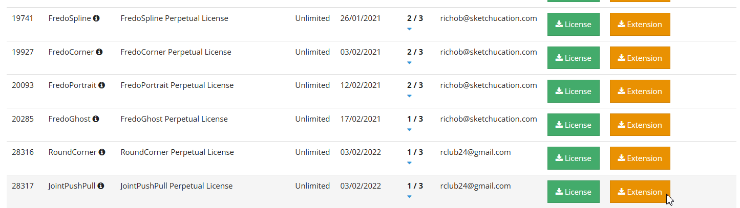

                        Hi can anyone guide me on how to release license seats? I have gone to sketchucation>global license status but nothing come up. but if i checked under my license page i have all the plugins i have purchased with number of seats linked to it. i need to unlink some as im not using that computer anymore.
                        • TIGT Offline
                          With the latest versions of the SketchUcation tools installed you should see the options on our web page or in one of the settings tabs in the ExtensionStore dialog ?
                          If not Rich will probably be able to do something via admin...
                            @nebhamzah
                            Releasing seats at My Licenses
