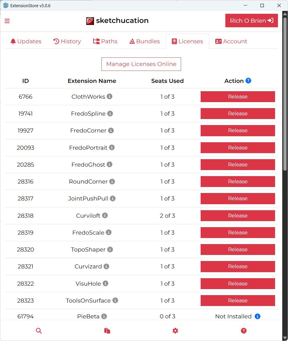

                                      • H
                                        Hugo Marreiros
                                        hi, i had to reinstall sketchup, but i remember to release the license first, but it still shows that i'm using one license, that is not true, how can i correct that?
