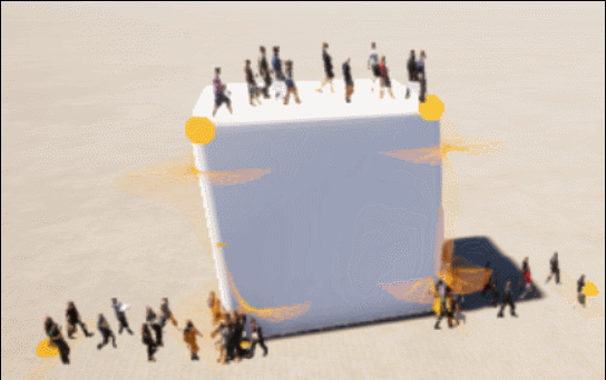

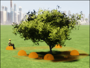

                      • pilouP
                        @HornOxx
                        Of course yes, (can be anything) because you can change personnage (above a building worker as pianist) and their Tools (Piano as mower) and their movements here following Building Workers can dance or make any movements of an existing animated personnages- Amazing! 😮
                        https://i.postimg.cc/W46djDR3/GIF-poses.gif
                        Of course path is just limited by drawing basic step line (in x,y,z yellow bases) but it's better than nothing and largely enough for funny results! 😉
                        Here only on (x,y) you see leaves moving just a little because strength of wind is too small !
                        https://i.postimg.cc/YC6H6RGL/GIF-tond.gif
                        but on z is possible too 😉
                        https://i.postimg.cc/L8Dxcvvb/GIF-pietons.gif
                        And you can even modelize the terrain like the SU Sand box (but more easy) if you want ! 🤓
                        A terrific free program! 😎
                        May little animation above (the Pianist mowering) take me less 3 minutes to make! Terrain vegetation flowers etc...from zero! ☀
