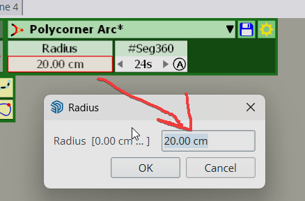

                      it'd be awesome if aux windows across all Fredo's plugins would focus on input field out of the box
                      fredo6F 1 Reply Last reply Reply Quote 0
                        fredo6 @rv1974
                        This is an issue in SU2026. In previous versions of Sketchup, the focus was on the field right away.
                        Nothing I can do, unless Trimble fixes it.
