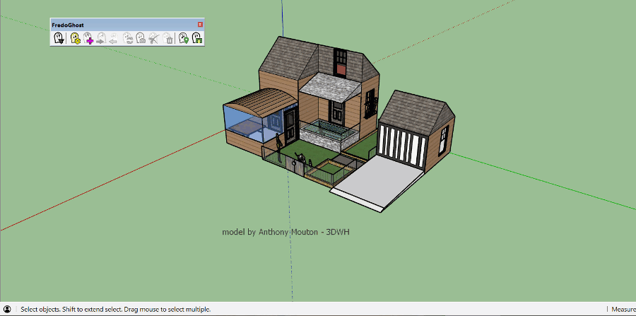

            By coincidence, I am finishing a new plugin, FredoGhost, that can create Ghost version of groups and components with various methods.
            In the example below, the House is split into 2 groups: Extension and rest of house. We just create a Ghost for the Rest of the House, with a grayish color. Then you can switch back and forth between the Ghost and Real version, so that you can do a print.

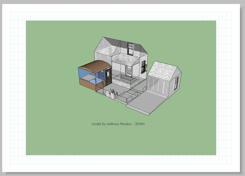

                    If I send the model to Layout, that's what I obtain.
                    Now, when I am in Layout, how can I import the view with the non-grayed house to put it side by side?

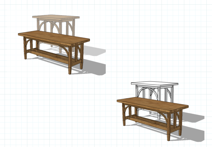

                      Fredo, it would require the use of multiple scenes in SU being used for stacked viewports. And if you don't do anything to the model, you can put a rectangle between viewports that has a reduced opacity fill.
                      Alternatively, the house could be shown with hidden line style and the added porch as you have it with shade with textures.

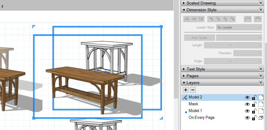

                            Fredo, each viewport in LayOut is tied to a different scene. For stacked viewports, I put each one on a different layer. So for the lower right image above, there are two viewports, each on a different layer. Here I've copied them and separated them a little so you can see there's two. The hidden line scene in on Model 1 layer and the textured one is on Model 2 layer.
                            It's easy to stack the viewports with perfect alignment because Paste is Paste in place. There's also an option in the right click Context menu to Paste to current layer. So I place the viewport on the Model 1 layer, adjust its size and position on the page as needed, copy (Edit>Copy, Right click>Copy, Ctrl+C), make the Model 2 layer active, right click and choose Paste to current layer. Then in the SketchUp Model panel or right click Context menu, change the scene to the textured one.

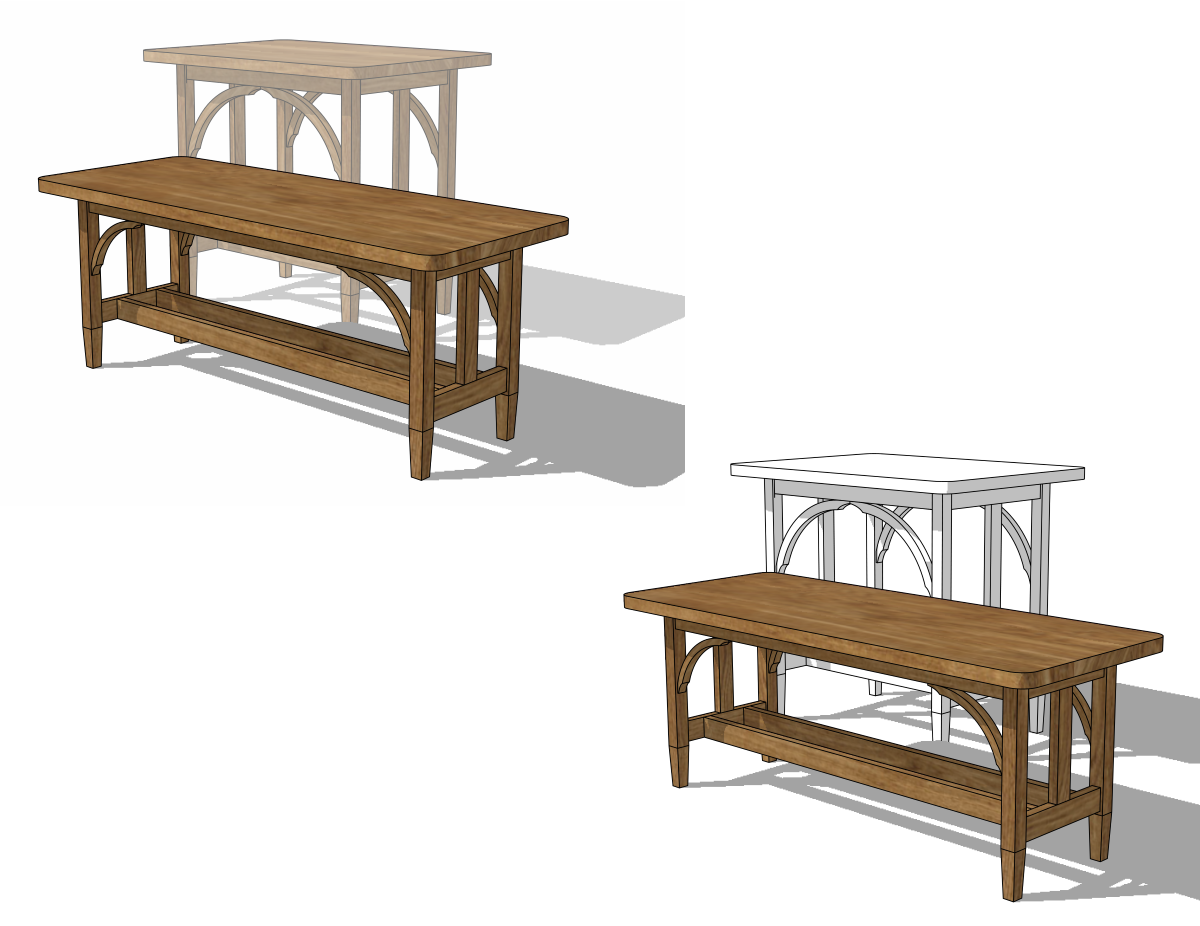

                            The other example with the faded background is done the same way but with a rectangle placed on the Mask layer. The rectangle has white fill with opacity set to 45%.
                            As Juju points out, it is important to not modify scenes in LayOut. If changes need to made to camera position or other scene-related things, that should be done in SU, saved, and then the reference updated in LO.
                            FWIW, here's an image export of the page above. A PDF would look similar.
