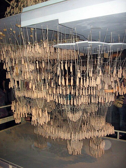

                  • V
                    voegel
                    I know that workaround but that is not what I really like
                    Sagrada Familia Museum - Barcelona - Hanging Model (= analog computing)
                    1 Reply Last reply 🙄

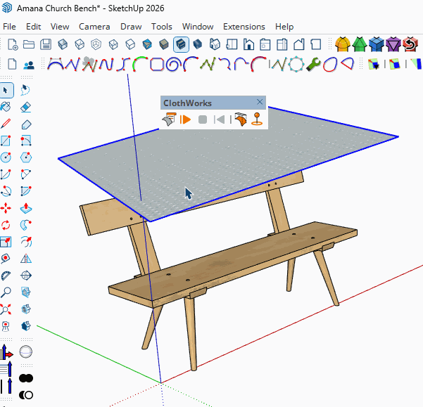

                    • J
                      jsinmichael
                      Can you please confirm that this extension works with the latest SU version? Thanks!
                        Rich O Brien Moderator @jsinmichael
                        It does. You can install it using Sketchucation Tools: https://sketchucation.com/plugin/696-sketchucationtools and trial it to check for yourself
                        1 Reply Last reply 👍
                          Visual proof:
