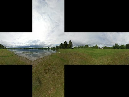

                It's an artifact related to cubic maps. Typically cubic maps need each face to have a small amount of barrel distortion applied to compensate for this.
                http://wiki.polycount.com/w/images/thumb/3/35/Cubemap_angular_distortion.jpg/600px-Cubemap_angular_distortion.jpg
                Cube map - polycount
                (wiki.polycount.com)
