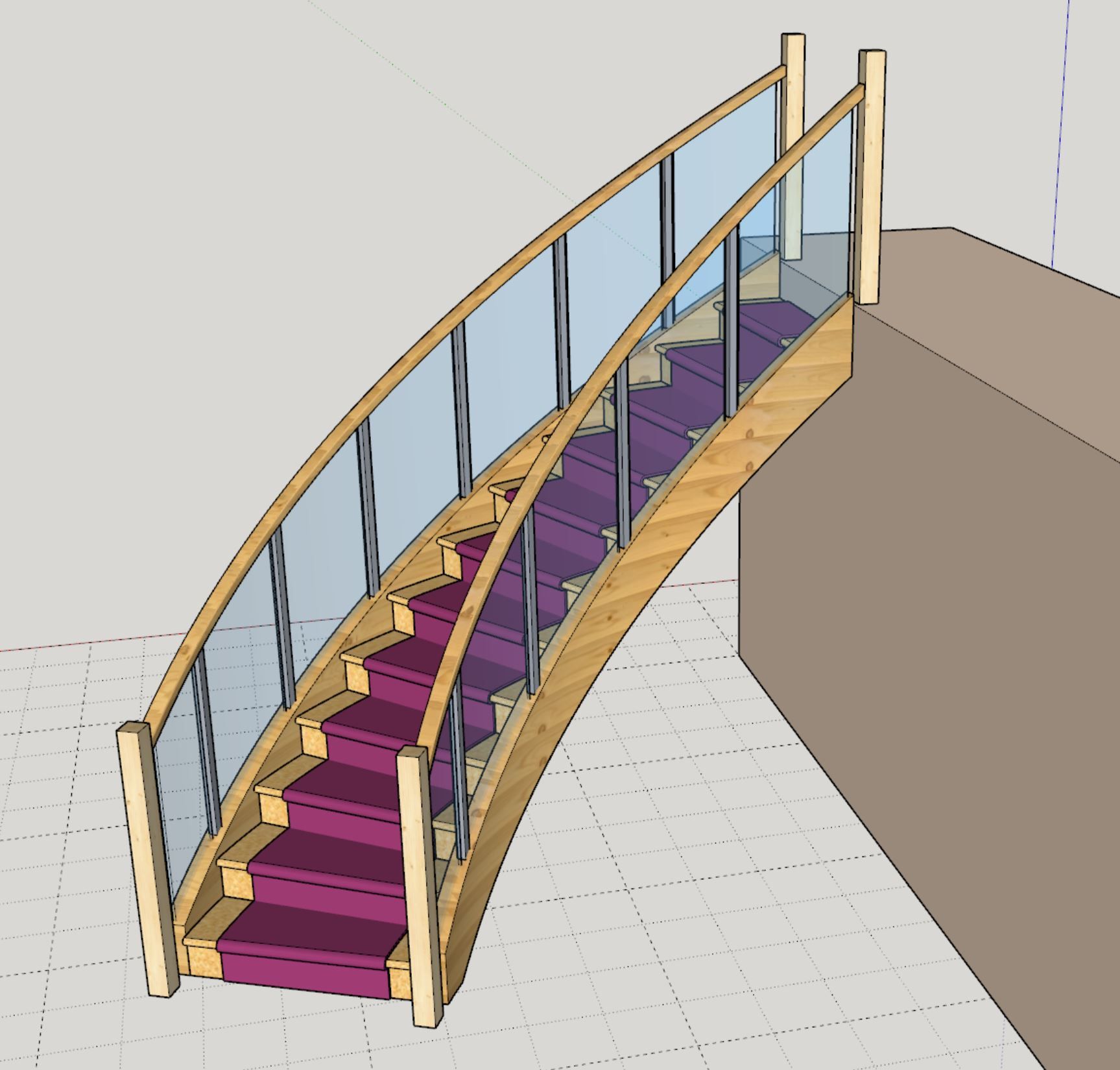

                          Version 4.6.5 - 06.18.2026
                          • Added a "GLASS" baluster option for curved stair assemblies (circular and elliptical).
                          wall_su1239_800.jpg wall_su1240_800.jpg wall_su1243_800.jpg wall_su1244_800.jpg

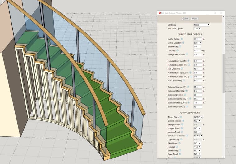

                                      On a related note as I’ve stated in the recent tutorial the regen time of this spline railings can suffer because of the large poly handrails and/or shoerails. In the next update I will be introducing and option where the user can toggle a “split” option for both the handrail and shoerail. This will split those two curved solids into separate segments (at the intermediate posts). For larger spline railing assemblies my internal testing has shown an almost 100% performance (draw, edit, regen).
                                      These two parameters will be found in the intermediate post sub-menu, see image below:wall_su1278_800.jpg

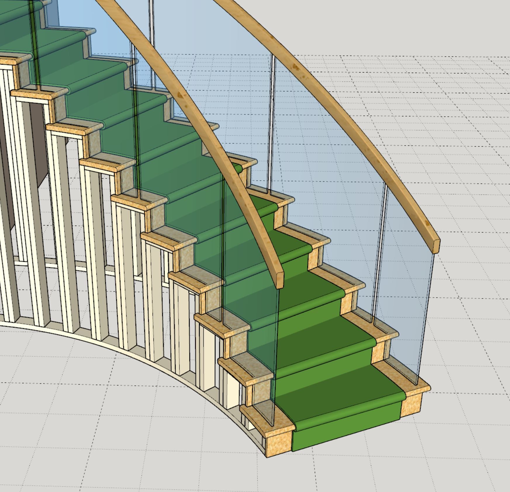

                                        Version 4.6.7 - 06.25.2026
                                        • Added a “GLASS” baluster option for curved and straight rail assemblies.
                                        • Added a “CABLE” baluster option for curved and straight rail assemblies.
                                        wall_su1278_800.jpg wall_su1279_800.jpg wall_su1282_800.jpg wall_su1288_800.jpg wall_su1289_800.jpg

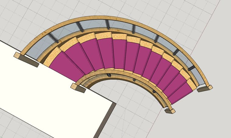

                                        • medeekM Offline
                                          medeek
                                          Version 4.6.7b - 06.26.2026
                                          • Enabled deck railing for spline railing assemblies.
                                          • Added a "GLASS" baluster option for spline railing assemblies.
                                          • Added a "CABLE" baluster option for spline railing assemblies.
                                          wall_su1290_800.jpg wall_su1291_800.jpg wall_su1292_800.jpg wall_su1293_800.jpg wall_su1294_800.jpg
