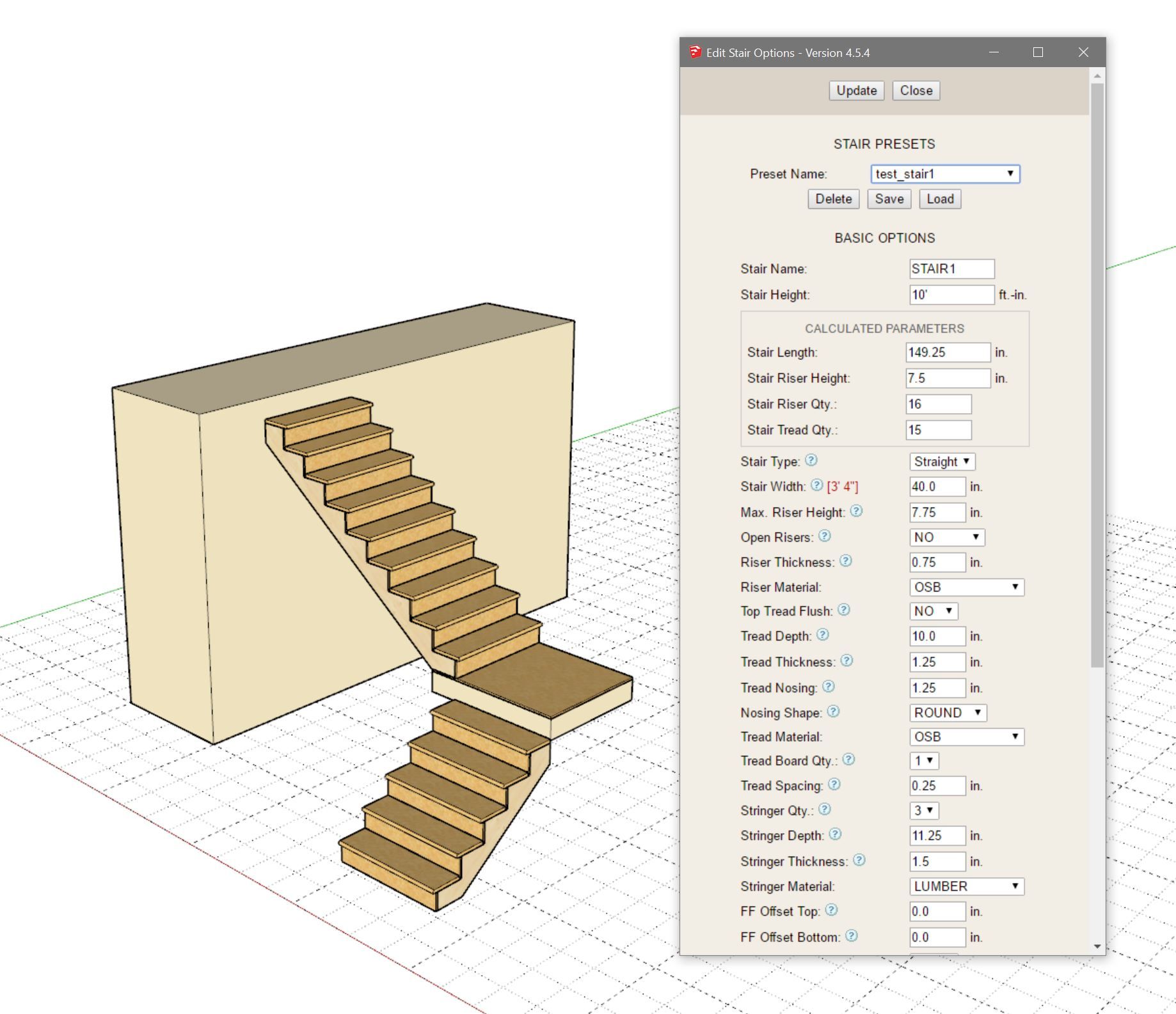

                    Version 4.5.4b - 05.22.2026
                    • Fixed a bug in the railing toolbar with metric units.
                    • Added preview thumbnails into the stair draw and edit menus.
                    • Added the following L.J. Smith handrail profiles: LJ6203, LJ6400, LJ6601, LJ6701.

                    • medeekM
                      medeek
                      Version 4.5.5 - 05.24.2026
                      • Enabled presets for railings within the draw and edit menus.

                          Version 4.5.6b - 05.25.2026
                          • Enabled presets for stairs.
