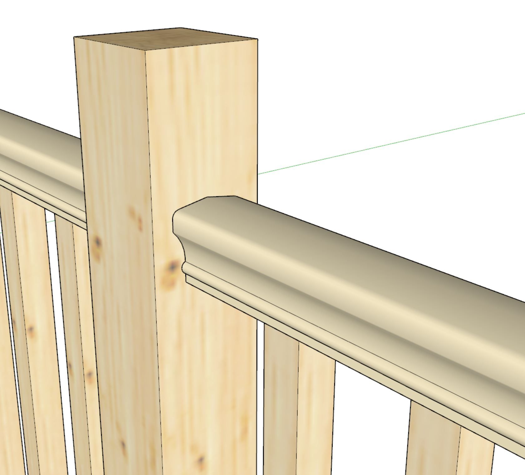

                        • Fixed a bug in the railing toolbar with metric units.
                        • Added preview thumbnails into the stair draw and edit menus.
                        • Added the following L.J. Smith handrail profiles: LJ6203, LJ6400, LJ6601, LJ6701.
