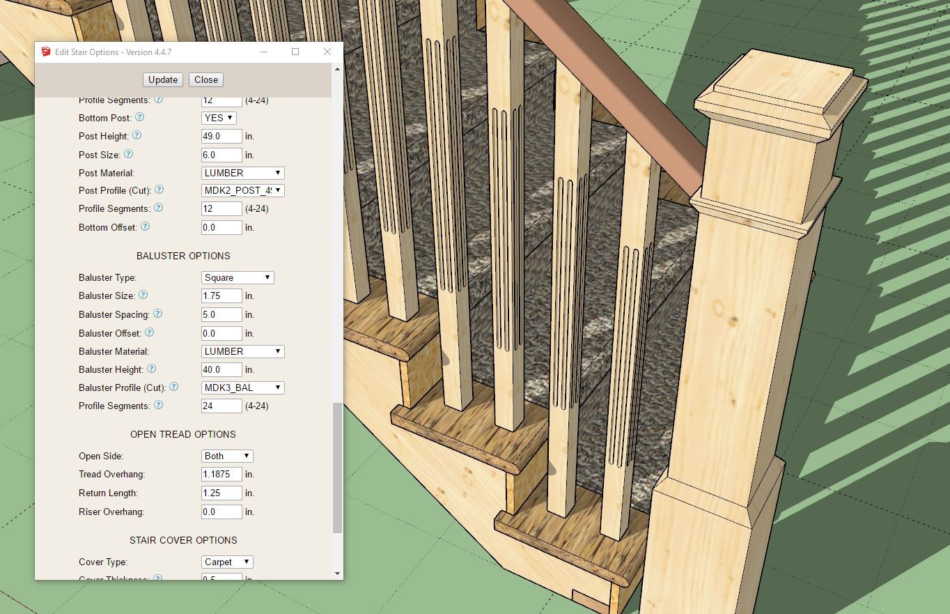

                    Version 4.4.7 - 04.16.2026
                    • Fixed a bug with custom door positioning for metric templates.
                    • Enabled "profile cutting" of posts for vertical handrails.
                    • Fixed a bug with the bottom trimming algorithm for balusters
                    Nathaniel P. Wilkerson PE
                    Medeek Engineering Inc
                    design.medeek.com
