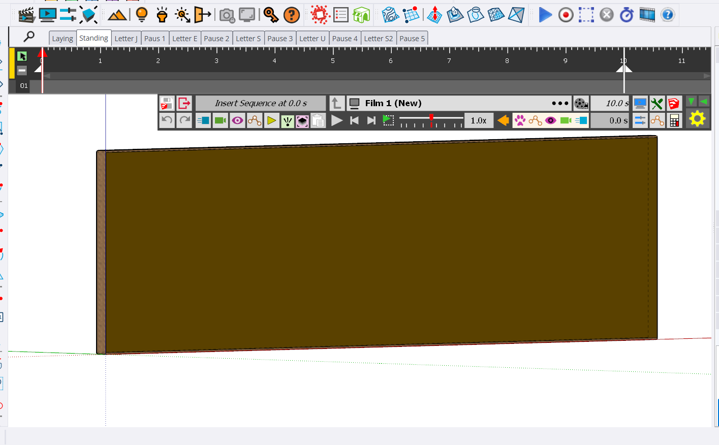

      Yes, I see that now and the Introduction scene is set to Perspective. I made sure all scenes were set to Parallel Projection and was now able to generate the video. So the camera setting turned out to be the issue. Hope others can learn from this.
      Yes, there are a couple of issue I need to clean up but as I said, I hope this will help others.
      Edited update
      OK, I am having a little problem. I have created a second version of the file that has all 3 scenes with the camera set to perspective. However, I cannot seem to get things so work correctly. Regardless of how I capture the camera the presentation of all 3 scenes winds up in the same perspective. I like for the plaque animation to be at an angle and the introduction and conclusion screens to be presented straight forward but I cannot get it to come out that way.
      Any advice/hints as to how to make that work and should we take this discussion to the Scene animation with Animator thread?
        I will look into the bug, which seems to concern camera interpolation when in parallel projection.
        I'll advise then.

                It's because you transition between a camera in perspective (Introduction) and a camera in parallel projection.
                There is no simple way to interpolate between both, eacept than to switch at a given time (beginning, end or middle).
                Considering your animation, I think all views should be in parallel projection.
                  Here is the video if you change the first Scene 'Introduction' to Parallel Projection.
                  Model Animation.mp4

                      I test with a model Jesus Palque.skp which had the Introduction Scene in Perspective and 2 other scenes in Parallel Projection.
                      The egenration of the video was showing the error you got too, which is due to the transition between camera in Perspective and camera in Parallel Projection
                      I will fix the problem, but if all scenes are in Parallel Projection, you can generate the video.
