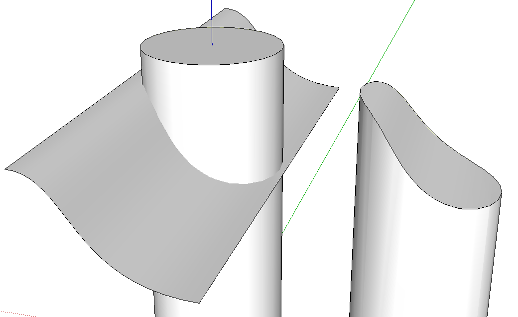

      Hello,
      I have little problem
      When i try to rotate just the top of a polygon, its all of the polygon its affected by the rotation of the top
      I just need a tool that let me rotate and keep the geometry like blender scale rotate by edge
      wrong :
      http://img15.hostingpics.net/pics/172825rotate.png
      Thank you in advance for your help

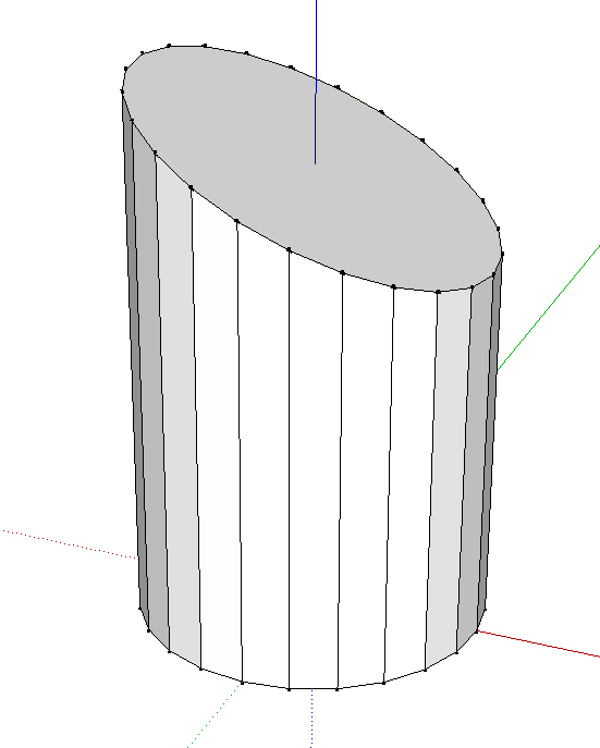

          Is this what you're after?

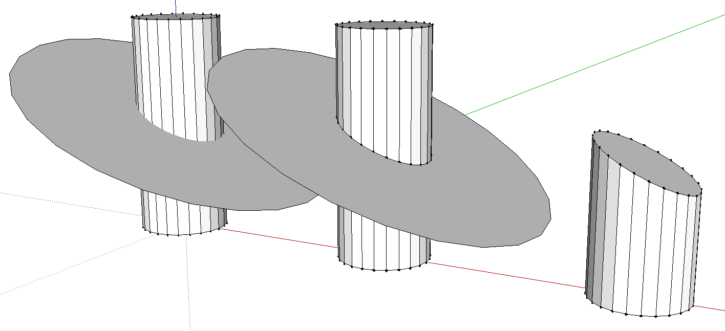

                What tool? I just approached the problem differently. Instead of rotating the top, I cut the cylinder off at an angle with a cutting plane. Draw the cutting plane at the desired angle and use Intersect Faces to create an an intersection. Then erase what you don't need.
                This method also makes it possible to make more complex cuts if you need to.
