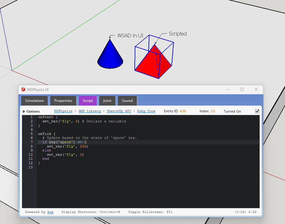

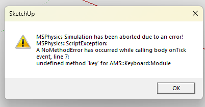

                                      Hello Anton or Anyone who could explain me for the problem.
                                      I've use SketchUp 2017 for long time together with MSPhysics (right now is version 1.0.3).
                                      They worked well and thank you very much to Anton that create a super good extension.
                                      But suddenly, the models that I using with MSPhysics has problems on running scripts that has user interaction such as using keys and mouse buttons. Everytime I run the script, it pop a window like shown here.
                                      https://i.postimg.cc/kgkQ6z8x/Screen-Shot-10-26-23-at-01-24-AM.png
                                      https://i.postimg.cc/6QMB1J0Z/Screen-Shot-10-26-23-at-01-25-AM.png
                                      I think, my problem is the same like "DanyLecoeq" and "hmau26" that they've posted before.
                                      https://i.postimg.cc/sDv7qXmj/Screen-Shot-10-26-23-at-10-18-AM.png
                                      • I Offline
                                        i-ss
                                        After long period of waiting. I've try to down-version of ams_lib from v3.7.1b (the last one, I think) to v3.5.2
                                        Then all back to work !!!
