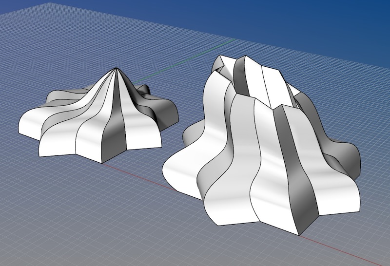

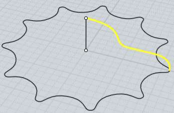

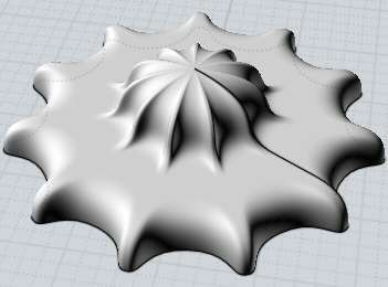

      why don't you use rhino to do this? seems like the best way-- especially if you're looking for fastest/easiest/most accurate..

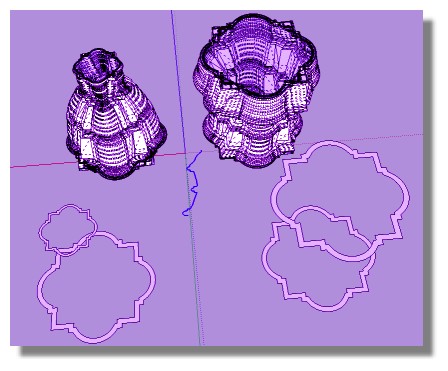

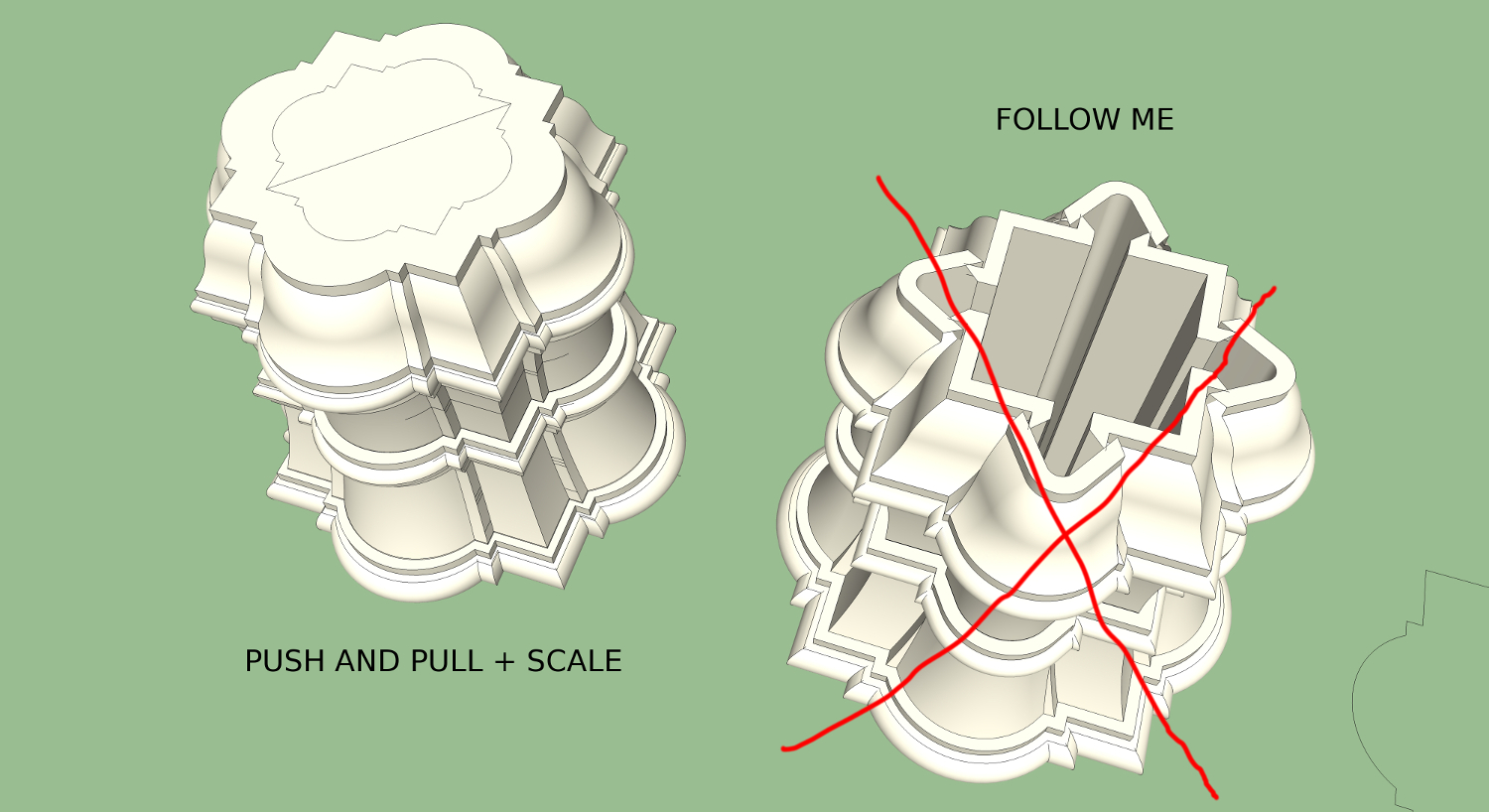

        I don't want to leave sketch-up for Rhino; I designed these shape with sketchup with much effort using only starting from rail profile basis push-pull + scale sveral times to follow the path preferred and editing free hands the model. When a friend of mine sowed me Rhino does it in one shot command I got crazy.. It is a challenge to do it in sketchup.
        Is there a good guy able to set up a plug in similar to "push-pull and scale following a path" (and an axis)?
        • T
          tambox
          if we have a push-pull and scale following a path of a 3d basis rail ( I mean a plan figure in 3d like a chipster) we can do it!
          • T
            tambox

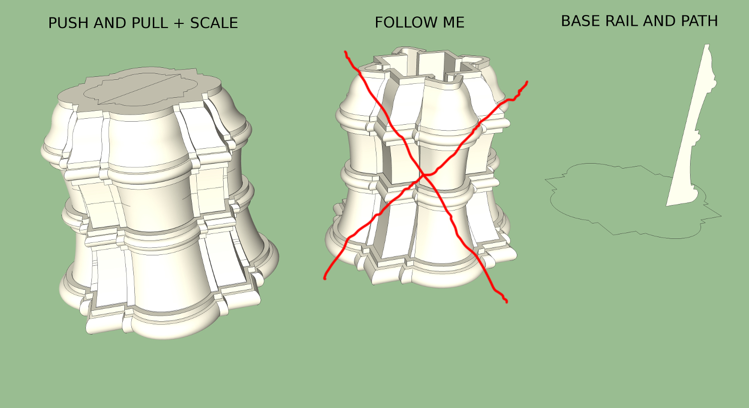

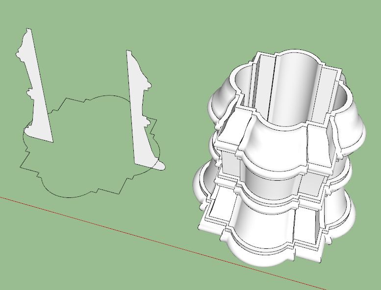

            here is a .skp file and jpg files showing as follow-me doesn't work but push/pull+scale work but working in a very slow way

                As Jeff suggested I'd need to set up in size and position my basis horizontal and connect them two each time with curviloft, but it is too long for my design as in samples I posted where I solved simply with repeated pull/push+scale.... I search something to short this process

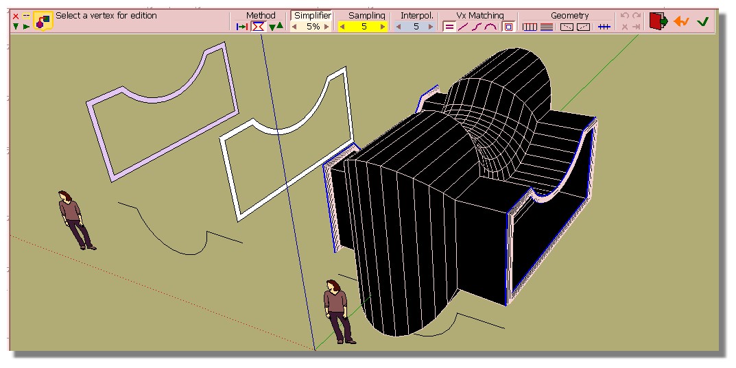

                    This is curviloft, as jeff suggested. Is it what you want to achieve?
                    I've simplified the profile because there was a ton of segments.

                                please give me setting of curviloft in this case: method? geometry?.... or a screenshot of your vedeo
                                thank you from italy
                                  Something like this πŸ˜„
                                  Separate the Profile (welded) for a better easy selection of the segments!
                                  Select the profil
                                  Select the surface
                                  (click twice on the middle of the surfaces - zoom it)
                                  Click Twice on the empty Space
                                  And curiously prefere an horizontal "profil"! (so just a rotation from my previous post! πŸ˜‰
