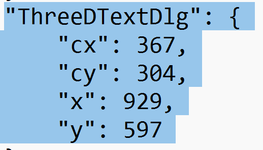

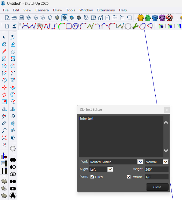

                            Close Sketchup. Go to user/AppData/Local/SketchUp/SketchUp 2025/SketchUp and open PrivatePreferences.json. Look for "ThreeDTextDlg". What are the "x" and "y" values? Edit those to move the dialog onto the correct screen. This is what it looks like on my computer.
                            And here's the dialog relative to the top left corner.
                            Note that the user/AppData folder is normally hidden so you'll need to make hidden folders visible in File Explorer.
