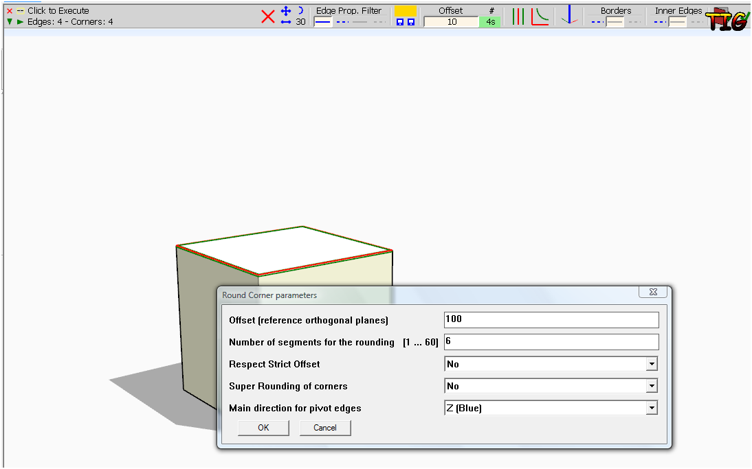

            I don't quite understand what you are doing. Probably a language thing. Anyway, take a look at this quick video.
            [flash=560,315:26rugp2x]http://www.youtube.com/v/fDCdX2sBVlY?version=3&hl=en_US[/flash:26rugp2x]
            It works the same way on my Mac, too.
            Activate the tool. Set the radius as needed.
            Click on the edges to be rounded. Do you see the colored lines when you do this?
            Move the cursor off the geometry and click.
            Have you tried running it with the Ruby Console open? Do you get any messages then?

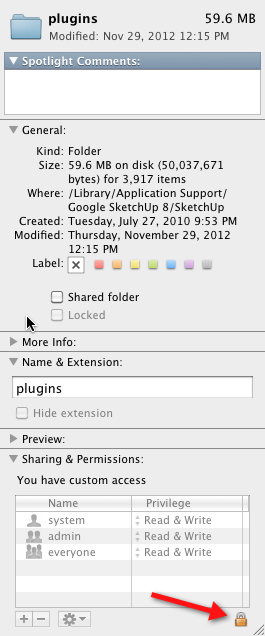

                    Check to see that the Plugins folder has read and write permissions set to allow.

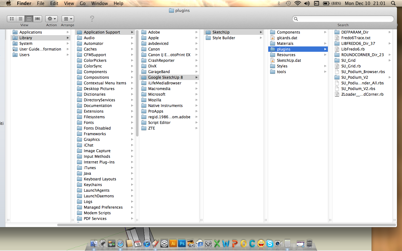

                    Post a screen shot of your Plugins folder, please.
                    • J Offline
                      joe depok
                      i am using macbook pro os Lion X 10.7.3 - it's not a mountain lion.
                      I put my plug in at : Macintosh HD / Library / application support / google sketch up 8 / sketch up / plugins
                      Note : There is no other sketch up I installed in my laptop.
                      Just for your info that other plugin I put on the same folder and all is running well.

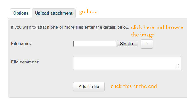

                      By the way how can I post a screen shot (put attachment on this post) ? .....
                      cheers
                      Joe
                      • massimoM Offline
                        massimo Moderator
                        See the picture below.

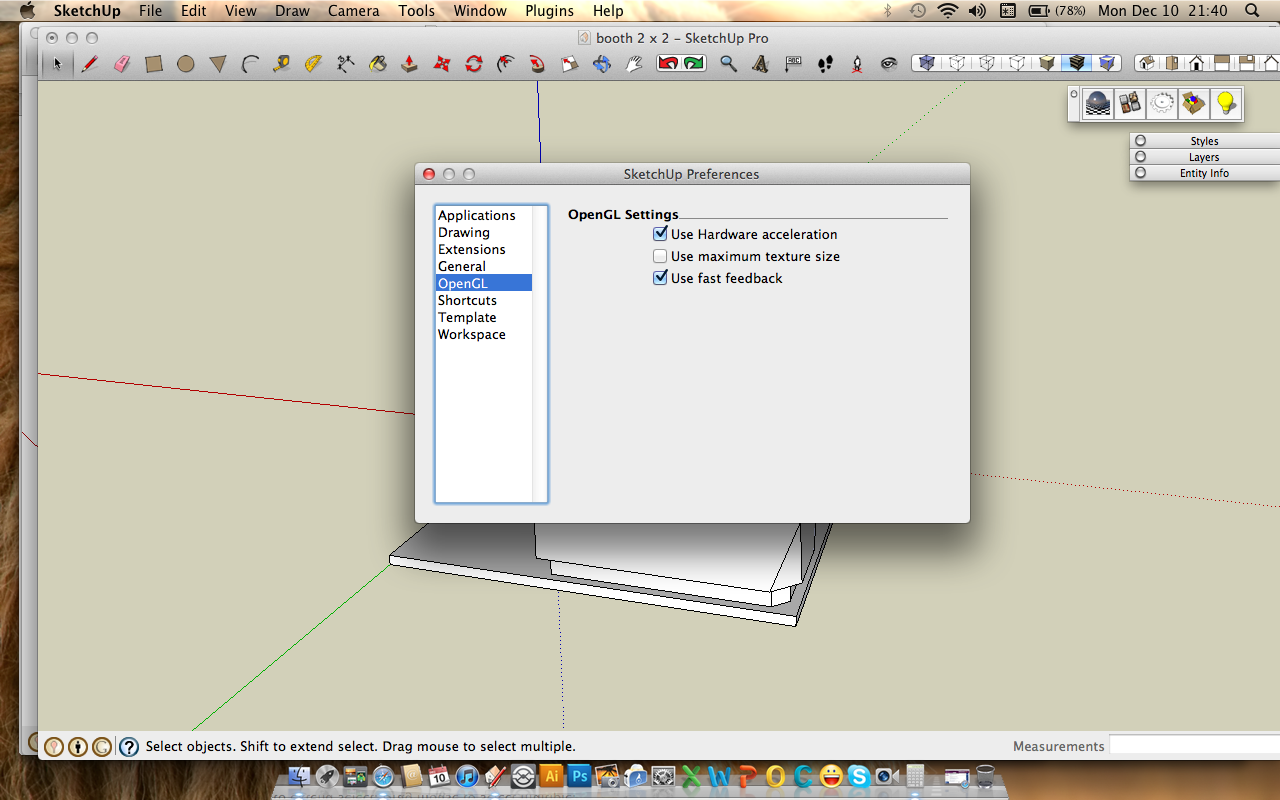

                          I wonder if it's an OpenGL setting issue. Go to the SketchUp menu (to the left of File) and choose Preferences>OpenGL and change the settings for Use Hardware Acceleration and/or Use Fast Feedback.

                            If you don't had full [read/write] permissions for the 'plugins' folder and all of its contents... then although you might have managed to wedge the files/folders in there and they appear to work at least initially, there are still some potential issues: e.g. Fredo's tools [and several others] need to write log/temp files into the 'plugins' folder, and/or make special subfolders for their own use... So if the permissions are at all restrictive you can get weirdness happening...

                              for the openGL setting :
                              (checked) Use hardware acceleration
                              (not checked) Use maximum texture size
                              (checked) Use fast feedback

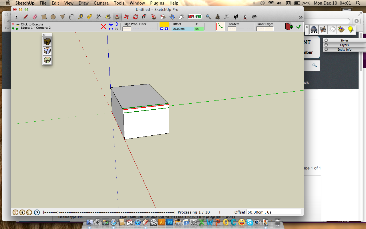

                              Here i attached the rounded corner display on my sketch up & the folder.
                              cheers
                              Joe

                                Did you try changing the OpenGL settings? πŸ˜’

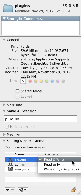

                                  really sorry but how do I do the permission ?

                                    this is the open GL setting
                                      Navigate to the Plugins folder. Right click on it and choose Get Info. In the lower right corner click on the lock to unlock it and then change all of the permissions to Read and Write.
                                        Twice I've told you to try changing it. Might as well skip it now, though. πŸ˜’

                                          You seem to have some of the files/subfolder that Fredo's tools make, so it's unlikely to a be permissions issue...
                                          You do have a very old version of LibFredo [37?]
                                          The current one is 47 ! Get it here...
                                          http://sketchucation.com/forums/viewtopic.php?p=144178#p144178
