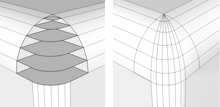

      I'm making a box with rounded corners on the vertical edges using a 3" radius, but I want to put a rounded corner around the top surface at a 6" radius. When I try to do this using Fredo6's rounded corners tool, I get the result shown in the picture on the left. I'm trying to figure out how to fill the void shown in the picture on the right. I have a feeling that there is a simple solution but I'm stumped...can anyone help? Thanks!

        What should it look like? Have you figured out a way to make that work manually?

          Chris - I want the missing corner shown in the right hand picture to be filled with a surface that is blending between top surface and the sides. I haven't figured out a way to do it manually yet!

            use curviloft by fredo
            (you may have to swap rails/profiles until you get the proper orientation)

              THANKS! I figured out how to do it manually like this, but I would much rather use the plug-in! Many thanks Jeff!!!!
              http://www.unigami.com/corner problem solution.png
