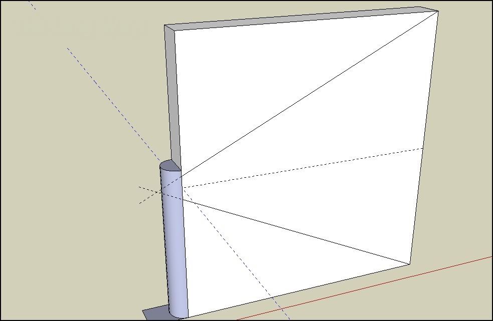

          http://i274.photobucket.com/albums/jj245/Spendauballet/SketchUp/thhandrail001.jpg
          In the process I have used , I have detached a particular case which I call "The simple way" 😎
          http://i274.photobucket.com/albums/jj245/Spendauballet/SketchUp/thhandrail002b.jpg
          This particular case fixes two parameters.
          1)the horizontal part of the handrail begins by a flat pure quarter of a circle. This way we only have to determine the curve for the remaining quarter.
          2)The climbing handrail must axes above the perpendicular axis exiting from the flat quarter of circle I just have talking about. This way the curve we have to draw can bend as a simple arc instead of a "S" curve (and we obtain this way a final shape much better adapted and beautiful)
          http://i274.photobucket.com/albums/jj245/Spendauballet/SketchUp/thhandrail004.jpg
          http://i274.photobucket.com/albums/jj245/Spendauballet/SketchUp/thhandrail005.jpg
          (the case to avoid:)
          http://i274.photobucket.com/albums/jj245/Spendauballet/SketchUp/thhandrail002.jpg
          http://i274.photobucket.com/albums/jj245/Spendauballet/SketchUp/thhandrail003.jpg
          I assume you know the need and the use of the following Plugins:
          -> Fredo6 BezierSpline (and its 20 sheets PDF !!)
          -> Didier Bur Projections Tools
          -> Rick Wilson Weld
          ->Didier Bur Lines to Tubes
          I assume also you know how use "Intersect with the model" by entering a group, select all and intersect, in order to recover the path of the intersection..
          Basically, my way is to project plane curves on semi cylinders and reversely.
          All modifications are made on plane curves.
          The understanding of the process, turns around the ability to imagine a flat curve projected in 3D. Please understand and note the necessity to make our original flat curve with endings tangent to the axes..
          ,..and a remark: it goes better if every part of the construction set is turned as a group!! 😉
          [flash=640,480:2tw86mrq]http://www.youtube.com/v/t1FfpfIiRB4[/flash:2tw86mrq]
