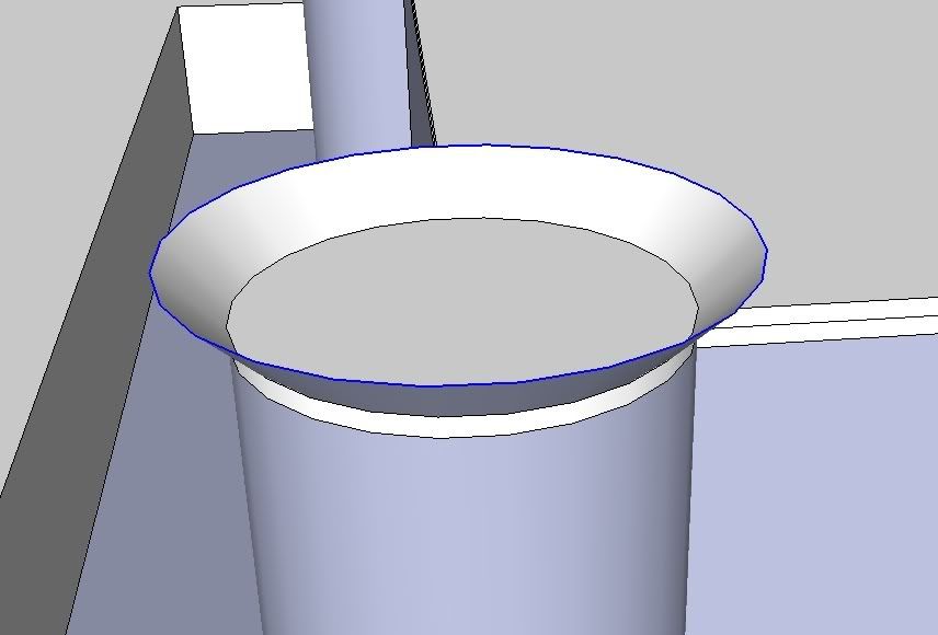

      Ok so I am making a basic reference model and I just started using sketchup. If you look at the picture included I have a cylinder that is beveled upward but the face of the circle is gone so my question is how can I fill the face?

        Draw a line a across the circle. This should close the face and then delete the line afterwards.

          Awesome thanks a lot πŸ˜„
            Or draw a line tracing an edge line. This will also fill in the face and you don't need to delete the line after the face is created. πŸ˜‰
