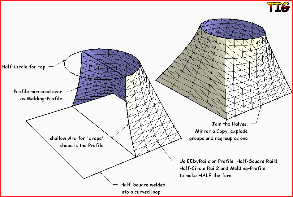

                  ik only have lathe is that the same as lath becease i did not get it right with this tool and the one with two halves will not work becease you controle the tensile force in the material by the tho guide lines and they are not the naturel way of tensile force
