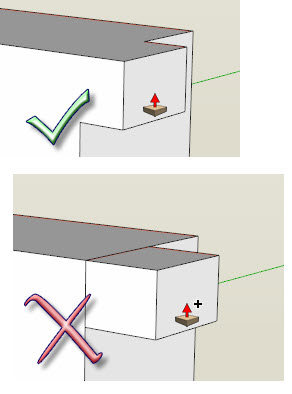

        pressing the ctrl key will toggle the plus sign by the push/pull pointer and toggles new face versus move face. try it its hard to explain.

            you have to make sure there's no plus sign beside the push/pull cursor or it will create internal faces.
            you could also use this plugin http://forums.sketchucation.com/viewtopic.php?f=323&t=25466 which removes internal geometry for exporting. 😄

              Actually the the image showing the "wrong" way is the way i want it but without the internal face(thats how all other 3d software are extruding an surface. So probably the plugin is what im looking for.
              here is an image illustrating how i want it http://piclair.com/data/uwkth.jpg

                well you can't do that with push/pull and not get internal faces. you can however make your cube the full height (from image) then select the top or bottom perimeter edges and ctrl copy them up or down as many times as you wish with no internal faces being created. 😄
