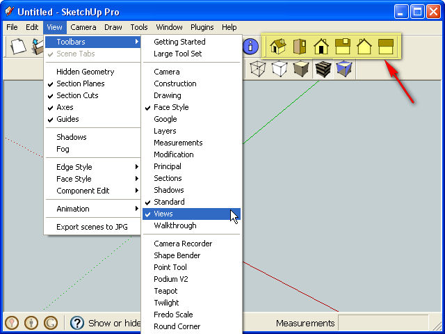

              I sometimes suspect SketchUp's default Toolbar set-up is less than optimal.
              Please don't be offended by this most basic of questions - is the Views toolbar enabled?

                @Jim : you know what ... i did'nt see it 😎

                  SketchUp is deceptively simple. Google promotes SketchUps ease of use, but in reality it has a huge number of settings spread over many menus and windows, and it's easy to overlook them.
