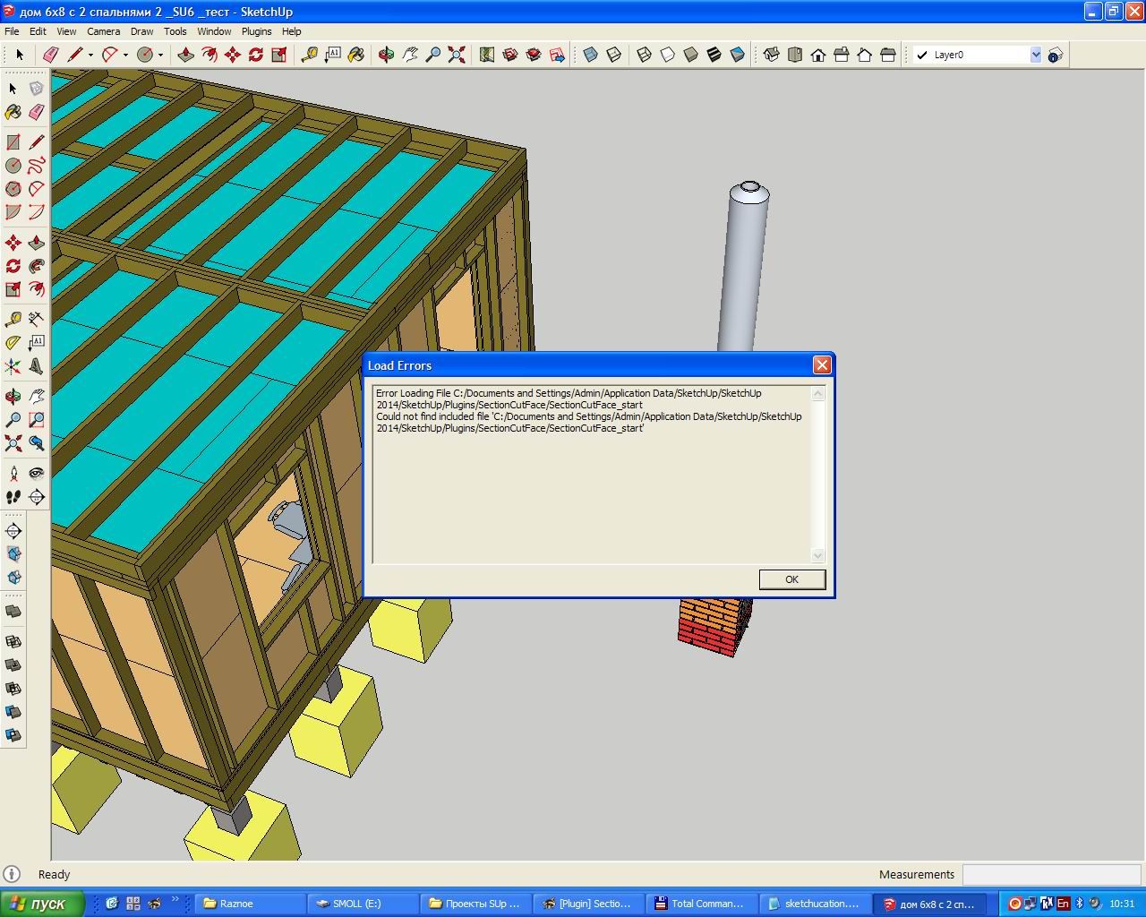

                                    Hi, TIG.
                                    This SectionCutFace_v8.0.rbz plugin does not work in WinXPSP3 with SU 14.
                                    Got a mistake see the pic pls.
                                    Is there possible to run plugin v.8.0 on WinXPSP3 + SU14 ?
                                    PS Version 6.2 works well.
                                      Sorry, it's best with v2017 or newer...
                                      V 1 Reply Last reply Reply Quote 0
                                      • V Offline
                                        vasia7777 @TIG
                                        @TIG
                                        But plugin's description says:
                                        "Compatibility: v2014, v2015, v2016, v2017, v2018, v2019, v2020, v2021/22, v2023, v2024, v2025
                                        Dependencies: Best in >= v2014 - PM TIG for earlier version fixes..."
                                        Is it wrong ?
                                          Whilst it is best with >=v2017 it can still work in earlier versions.
                                          But your error message suggest that it hasn't even been installed properly.
                                          It is a 'load error' saying it can't find SectionCutFace_start.rb in its subfolder.
                                          For each extension, in your Plugins folder you should have a loader file, say 'xxxx.rb', and a subfolder with a matching name, say 'xxxx'.
                                          In that subfolder there should be the main code file(s) [RB or RBE] and any other files needed by the tool.
                                          Check your Plugins folder and try reinstalling the whole set of files/subfolder...

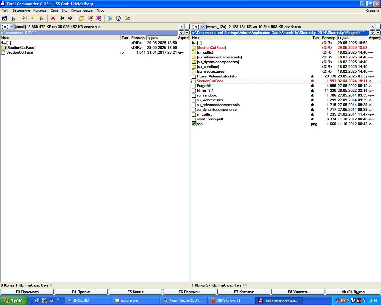

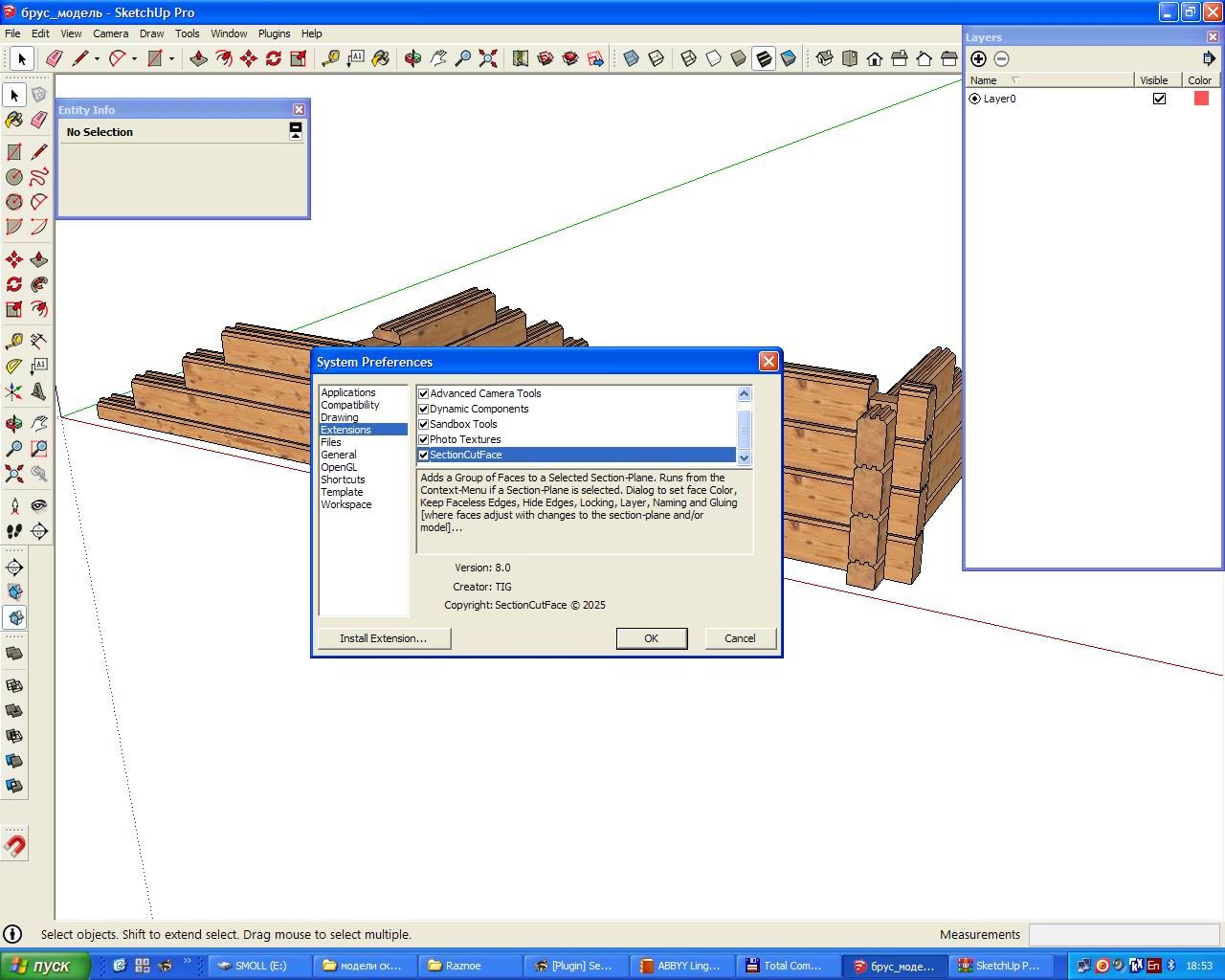

                                          • V Offline
                                            vasia7777 @TIG
                                            @TIG
                                            Yes, it is clear.
                                            Plugin was reinstalled twice.
                                            Plugin folder has SectionCutFace.rb
                                            Subfolder SectionCutFace plugin has SectionCutFace_start.rbe file.
                                            Everything have made as you said but the same error gotten.
                                            Pls see pics:
                                            What is wrong pls ?!
