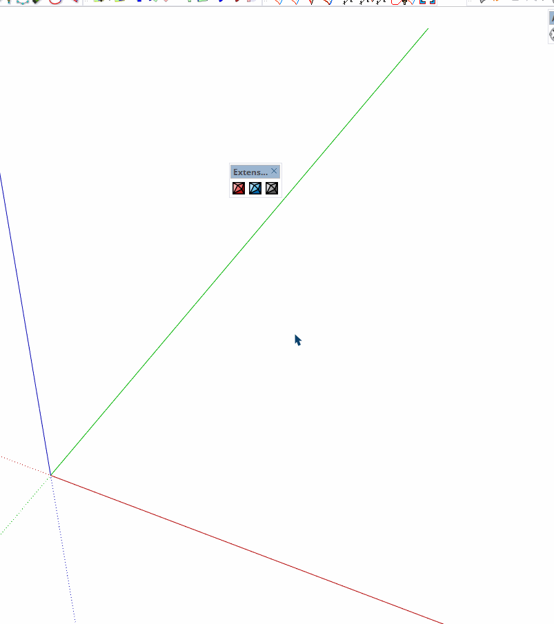

                                        • guanjinG
                                          guanjin
                                          cannot be set in sketchup2015, all Chinese is empty.
                                          I come from China, is to learn
                                          • fredo6F
                                            fredo6
                                            Can you be more explicit for the problem.
                                            I do have the Chinese in SU2015
