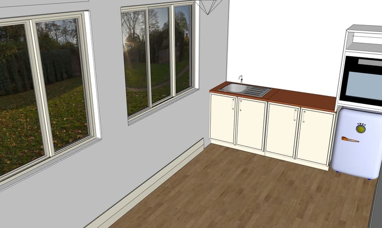

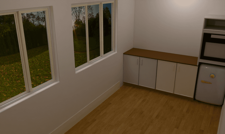

                                    Kitchen area, note missing colour/items 2d export versus render.

                                      May have needed a restart which cures some content glitches.
                                        Is the container(group/component) painted or the raw geometry? What does Entity Info say regards the selected container?
                                          Mike AmosM 1 Reply Last reply
