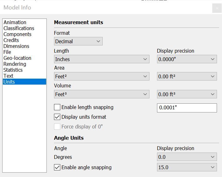

                    • Gus RG Offline
                      Gus R @ntxdave
                      @ntxdave If it's to scale you don't have to scale the model. It should be easily "converted" to inches.
                      Go to Window: Model Info: Units and change it from architectural to decimal and select inches.
                      It's will be in decimal inches.
                      You can also change it on the fly using the plugin "Toggle Units."

                        • ntxdaveN Offline
                          ntxdave @Gus R
                          @Gus-R said in Silly/Dumb Question about Guidelines:
                          Yes, I can change the units in the model but what I really need is to scale the model so that it now is in inches instead of feet. Therefore, if I drew an object that was 12' x 12' i would really like to scale it so that it is now 12" x 12".
                          With either of the methods you suggest (which BTW I appreciate) it does show the dimensions in inches instead of feet but I really want to convert (scale) things from feet to inches. So far, I have not found a method to do that.

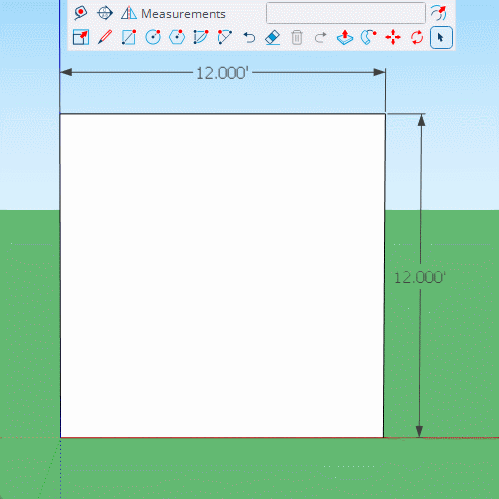

                                • BoxB Offline
                                  Box
                                  Here's an example with the tape.
                                  You can tap ctrl to remove the little plus icon but it is not essential. That just turns off making guides, but if you go from endpoint to endpoint it won't make a guide anyway.
