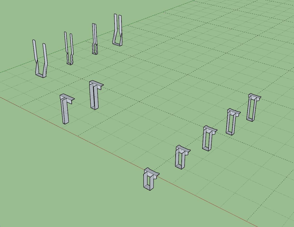

                                    Version 1.1.1 - 12.15.2025
                                    • Added the following face mount Simpson hangers into the built-in library: THA422, THA422_2, THAC422, THAC422_2.
                                    • Added the following top flange Simpson hangers into the built-in library: WP48, WP410, WP412, WP414, WP416, HWP156, HWP356.
