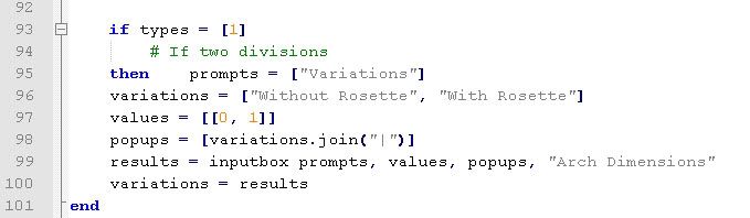

      I have a block of code which intends to create variations of gothic arch. All it does so far is to:
      Prompt a UI popup asking the user to enter 3 parametric variables ["Base Height", "Base Width", "Arch Height"] and select 2 drop-down menu variations ["Type", "Glazing"].
      http://i77.photobucket.com/albums/j78/Levethian/6.jpg?t=1261419676
      http://i77.photobucket.com/albums/j78/Levethian/7.jpg?t=1261419678

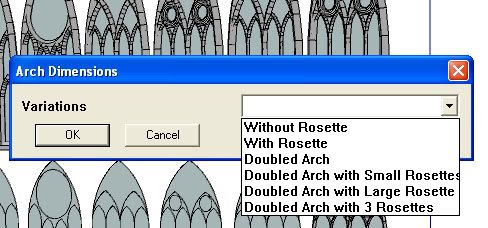

      Prompts 7 other new drop-down menus. ["Rows", "Variation"].
      http://i77.photobucket.com/albums/j78/Levethian/3.jpg?t=1261419061
      http://i77.photobucket.com/albums/j78/Levethian/8.jpg?t=1261419678

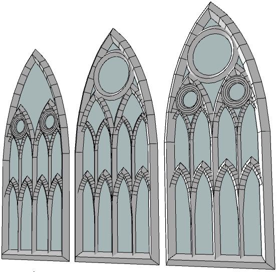

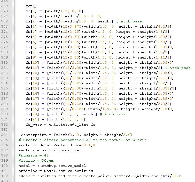

      Based on the parametric variables, the rest of the code designates points to draw, and draws the wire-frame of 20 types of archway.
      http://i77.photobucket.com/albums/j78/Levethian/4.jpg?t=1261419137
      http://i77.photobucket.com/albums/j78/Levethian/9.jpg?t=1261419679
      ...And that is all. The parametric parameters and equations for the points function as expected.
      ❓ My problems start as follows:
      I don't want the 7 pop-up menus to prompt, and I don't want all the arch type wire-frames to load at once. 2 menus max should prompt depending on the user-selection of 'types'. How do I link the values of "types" [0, 1, 2, 3] to blocks of code to load? Do I need to implement a data system?:
      http://i77.photobucket.com/albums/j78/Levethian/2.jpg?t=1261419059
      Or can either of these problems be addressed by 'If True Then Else' commands?

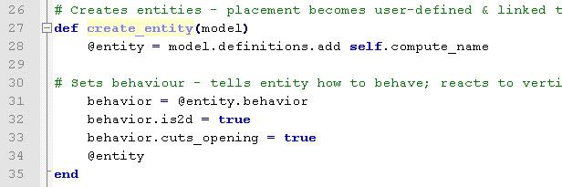

      My final problem will be to include functionality which allows the groups to be instantiated as a component which snaps to planes and cuts into surfaces. (I think this would involve the overhaul of the point-arrays to include 'origin' instead of (0, 0, 0), and then tell the origin to be user-defined..)
      http://i77.photobucket.com/albums/j78/Levethian/11.jpg?t=1261420435
      (from reference script)
