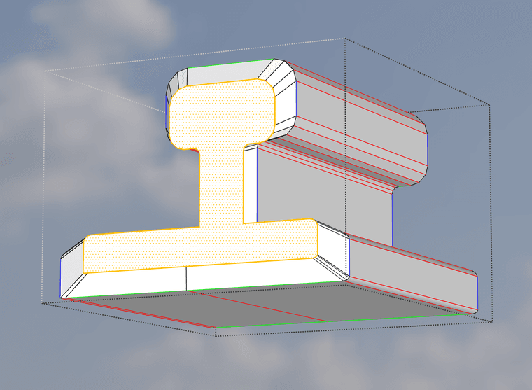

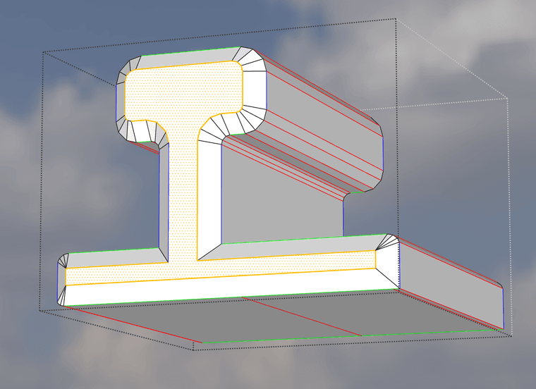

      I’ve found one issue that only appears with concave shapes.
      On convex curves the embossing works flawlessly, but on concave sections the displacement direction becomes inverted or distorted.
      Below are two screenshots:
      This is how the emboss should look (approximately, made by hand):
      This is what Emboss actually generates on the same concave shape:
      The difference is only in the normal direction handling at concave vertices.
      If the algorithm could detect concave angles and flip the displacement direction accordingly, the result would be perfect.
      Would it be possible to adjust the normal calculation so concave vertices receive a correct inward/outward direction as well?
