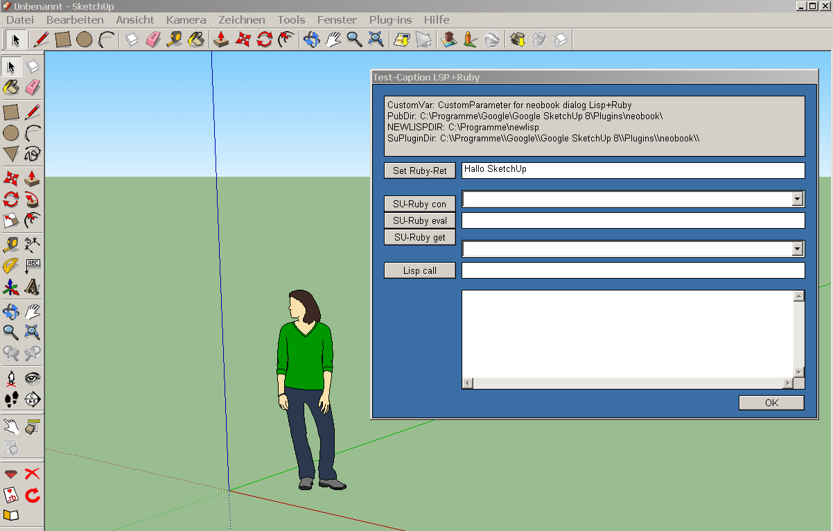

    • Neobook application builder in Sketchup
      Hello,
      For a long time I use the Rapid Application Builder tool neobook for programming windows software:
      Then comes the idea that it would be nice to have all that options in sketchup for user interface creation.
      Similar to my newLISP+pdScript integration into Sketchup, I build a neobook extension for Sketchup.
      The plugin DLL interfaces to the OCX of the neobook enviroment and loads there a neobook PKG file.
      The neobook dialog can be extended by its own plugin system.
      Windows only!
      Hardcopy:
      http://www.hpwsoft.de/anmeldung/html1/sketchup/NB_SU.png
      Interested who want to try it can download here:
      http://www.hpwsoft.de/anmeldung/html1/sketchup/sketchup4.html
      The ZIP contains 1 file at the toplevel:
      neobook_ext.rb
      The rb is the extension which must be activated in the preferences.
      The subfolder contains the DLL's and samples. Preserve the folder when you unpack the ZIP.
      The extension adds a menu to the plugins menu with some demo.
      The Win32API extension is needed from here:
      http://forums.sketchucation.com/viewtopic.php?f=323&t=42732#p380121
      Regards
      Hans-Peter
      posted in Developers' Forum
