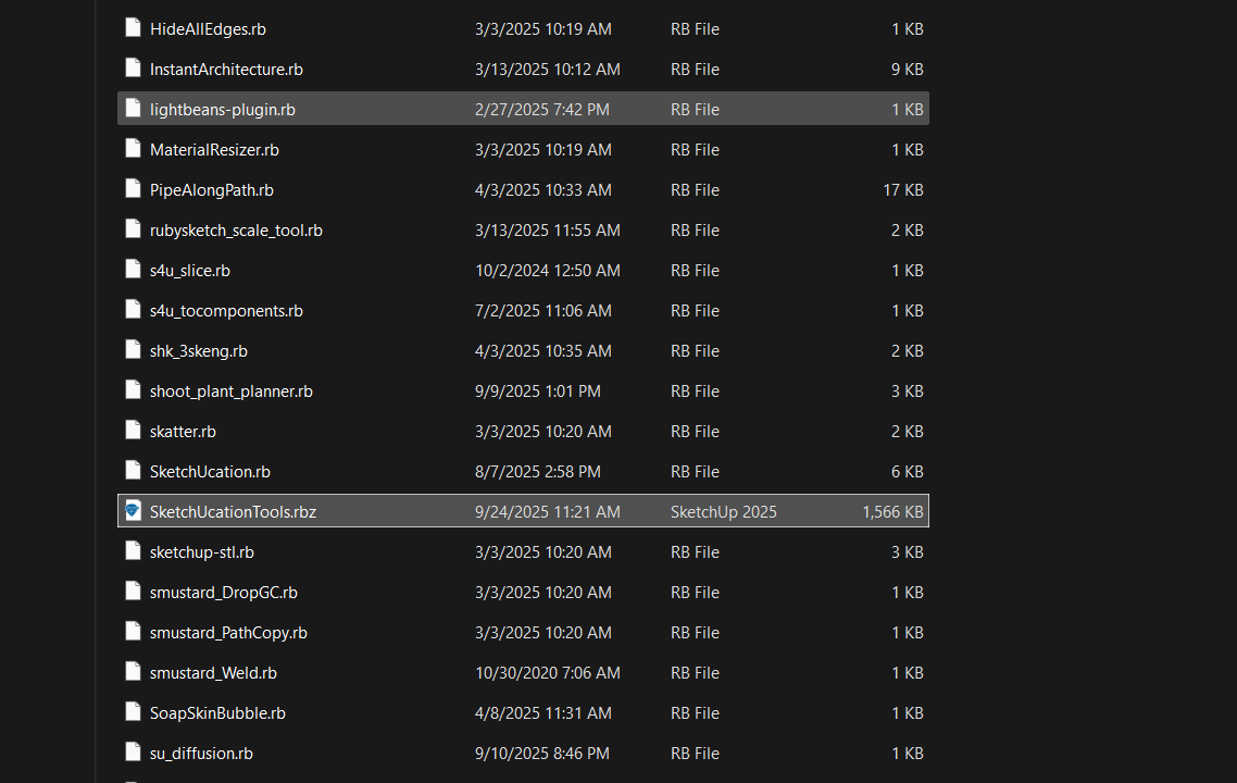

      If you follow the file address you can see I have the 5.0 file in the file for SketchUcation.
