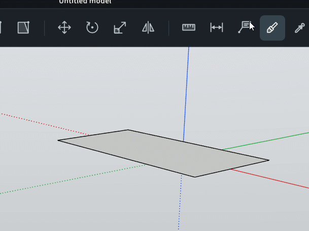

                    • pilouP
                      @pixelcruncher
                      Cool for hide axes for snapshot screen : my prompt will be smaller! πŸ™‚
                      For any reason , axes by default are not on the middle of the screen! ???
                      (even you close the Properties pannel!
                      Lines are now of the colors axes when parallel of the axes!
                      Request : Extrude Line(s) (very useful) !
                      @ntxdave You draw Guides with Measure (T) (not Dimension πŸ˜‰
                      Draw them from a line (segment) and Enter a measure!

                        • pilouP
                          @pixelcruncher
                          About the guides lines and points guides
                          It's a pity that we can't draw aonother guides lines from existing guides lines or intersection of Guides lines -(only measures)
                          Points guides are well drawn from a corner of segments but sometimes they are drawn from a segment!
                          So it's not very clear! πŸ™‚
                          Ps Will be fine also if drawinng line can be colored by axe's color when // to them !
