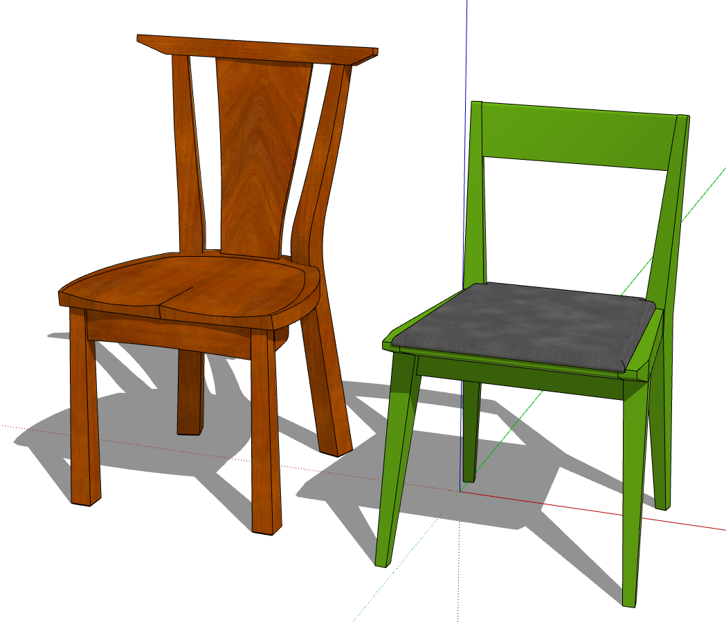

            @fredo6 No, no, I understood correctly. Basically, I’m attaching this image where the green staircase is out of scale, but I know the exact height. So what should I do? Should I press Tab and then…? Or should I scale it by picking a corner and typing what exactly?![alt text]SketchUp_hWGI1oHWVX.jpg
                  Those are call chairs where I come from. 😎
                  alexpacio2013A 1 Reply Last reply

                    @Dave-R The green chair does not have the same dimensions as the other chairs. I only know the blue axis, the height, because many catalogs only list the height. So I just wanted to know whether it is possible to resize it by knowing only the Z axis. If that is not possible, I will keep doing it with standard SketchUp. I’m sorry, because I love FredoScale so much that I would completely give up the standard scale tool. But I think this is not an impossible change, and in my opinion it would be very useful.
                      Proportionally scaling the chair based only on its height most likely won't yield the right dimensions for depth and width, though. If, for example I proportionally scale the chair on the left to be the same height as the one on the right, the seat would end up both too narrow and too short front to back.. Scaling proportionally would also result in reducing the seat height which wouldn't be correct for the chair.

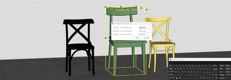

                        • fredo6F
                          fredo6
                          Here is the workflow with FredoScale
                          • you hover a handle
                          • you press TAB
                          • in the dialog, you type the dimensions
                          FredoScale - Rescale by dimension with TAB.mp4
                          If the handle corresponds to several degrees of freedom, you have 2 or 3 dimension fields showing up.
                          You can also set dimensions:
                          • with Uniform scaling. So, setting one dimension will set the others
                          • without Uniform scaling, where you can set individual dimensions.
                          HOWEVER, I realize that there are bugs in this dialog box, which I have not been made aware. So, I will fix them.
                          But here is the workflow. At the time of design, I thought this was much clearer than to rely on the VCB where the distinction between a scaling factor and a dimension requires that you type a unit, and also where it is fuzzy when you want to change several dimensions.
                          In addition, the fields accept formulas, like "4 * (2m + 3')"

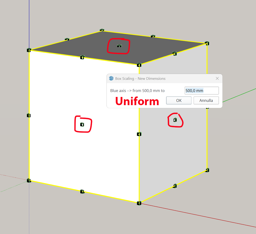

                          • alexpacio2013A
                            alexpacio2013
                            I’m waiting for the change that will add uniform scaling, which will allow you, as in the video you made, to resize one axis and have all the others scale uniformly. It would be enough to add a checkbox in the TAB options field table.
                            • fredo6F
                              fredo6
                              The bug was in LibFredo6.
                              I published a fix as LibFredo6 v15.9d.
                              I also adjusted the Dimensions dialog box to leave more space for the Length fields where you can enter formulas. This is in FredoScale v3.7a.
                              Here is a video on how to use the specify dimensions by keyboard.
