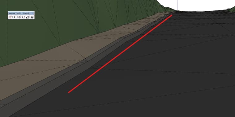

      I have a road with a curb that was imported from Revit. I would love to have the road edge and curb vertices appear smoother, like what you would get from the flatten tool in Vertex Tools, but I want to keep the vertical distance of the curb. I have tried to accomplish this with Artisan2 but it also struggles with this. Any ideas? Here is a screenshot.

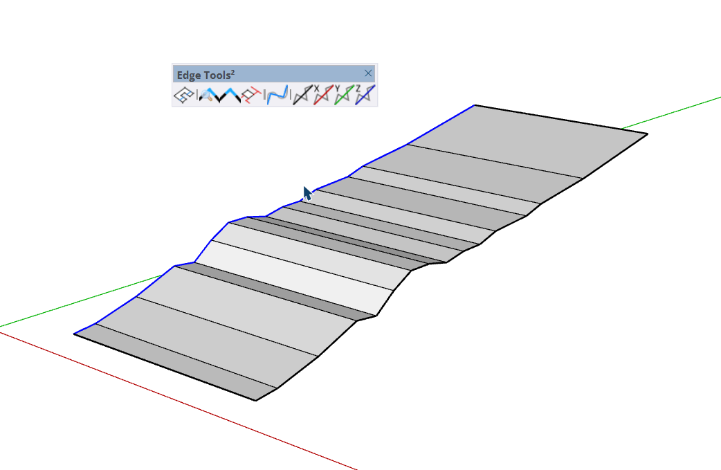

        Did you try Edge Tools?
        https://sketchucation.com/pluginstore?pln=tt_edgetools
        It has a Straighten Co-Linear tool...

          panixia @Rich O Brien
          @Rich-O-Brien
          So much triangles 😎
          Btw, Z colinear could work better if the road is not supposed to be perfectly straight in XY.
          @valerostudio I'm refining a tool that can do this interactively (along with many other freeform modeling features). It also integrates very well with Artisan2 and VertexTools/SubD. Let me know if you're interested in beta-testing.

            @panixia very much interested! Site modeling is always such a pain!!!

              the most practical way with the nicest results is to rebuild it with PB. the path is in the middle of the road, the profile is a horizontal line (the length is longer than your road width+sidewalks). then project sidewalks and make curbs with PB.
