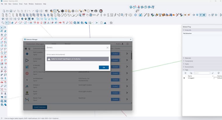

      I have a licensed Toposhaper plugIn but when I try to install on SU 2026 I get the message
      Failed to install?
      Anybody know how to solve this?

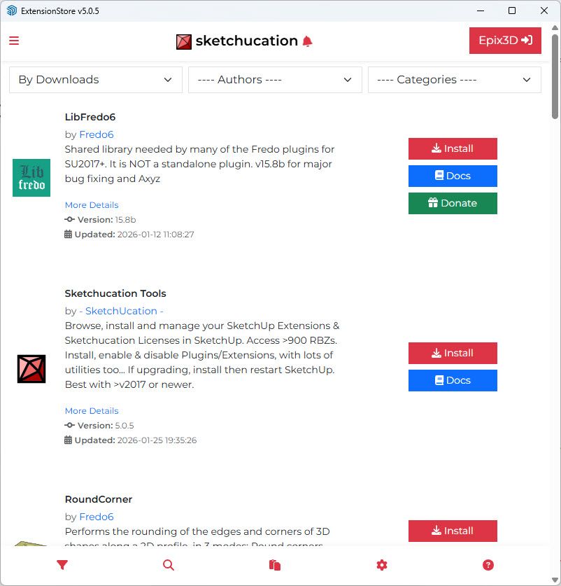

          If it is licensed you must already have the SketchUcation toolset installed to cover the licensing.
          Use the SketchUcation toolset's ExtensionStore dialog to first check that you have the latest toolset version installed - if not then install it and restart Sketchup.
          After that use the ExtensionStore dialog to Auto-Install the latest LibFredo6 extension, and restart SketchUp
          After that use the ExtensionStore dialog to Auto-Install the latest version of Toposhaper, and then restart SketchUp.
          Any improvement ?

            I used your method step by step TIG -still cannot find Toposhaper though the install says success. I did turn on and off SU for each step.

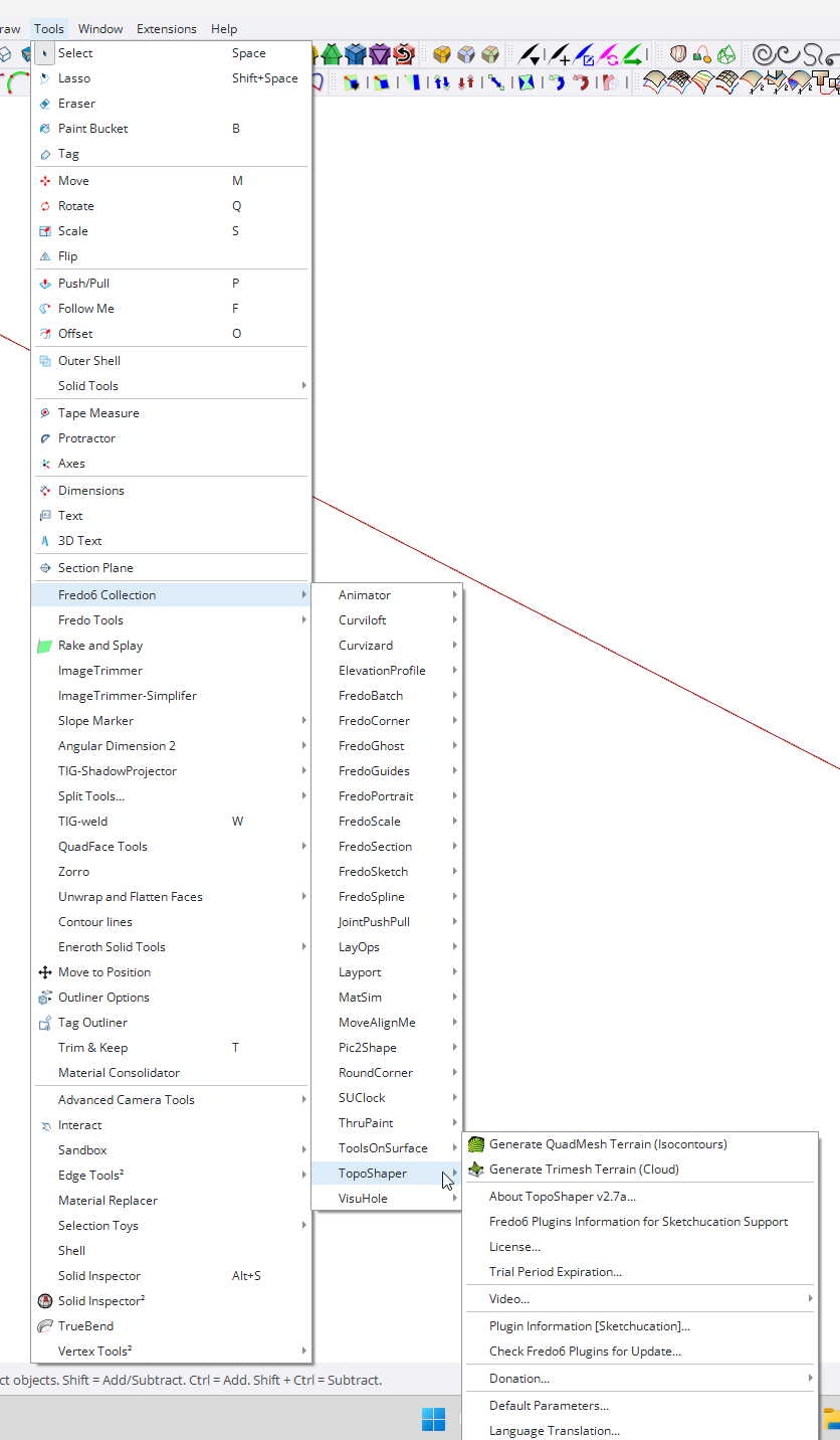

              You need to read its usage instructions AND also install LibFredo6 [as well as SketchUcation tools] which contains supporting code.
              Most of Fredo's extensions appear under the Tools menu, Fredo6 Collection > TopoShaper - It also has a Toolbar which you can activate...
                Illustrating what TIG described.

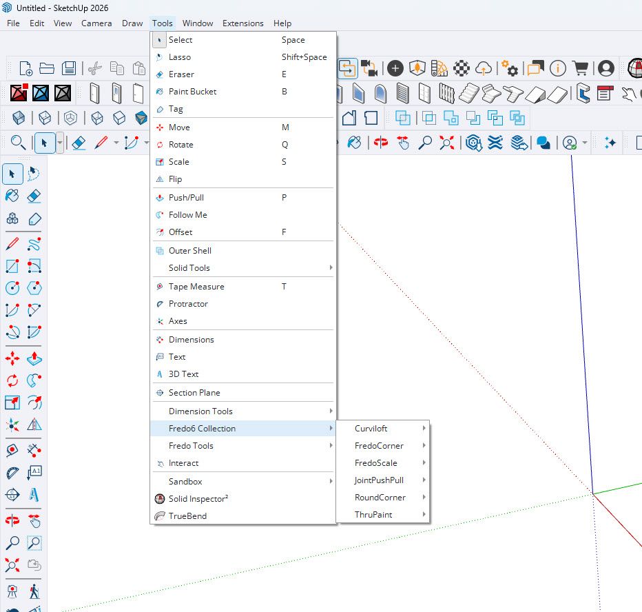

                • Epix3DE Offline
                  Epix3D
                  Sorry,- but still not showing up...

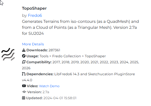

                    If you download a brand new copy of TopoShaper RBZ from our PluginStore and manually install it with the Extension-Manager do you still get the installation error message ?
                    https://sketchucation.com/pluginstore?pln=TopoShaper
                    I just installed it and it's fine, BUT I did notice its reported as 'unsigned' after the install. so perhaps @fredo6 needs to fix that.
                    Also, if your Extension-Manager Loading-Policy is set to anything other than 'Unrestricted' then that might be causing issues ?
