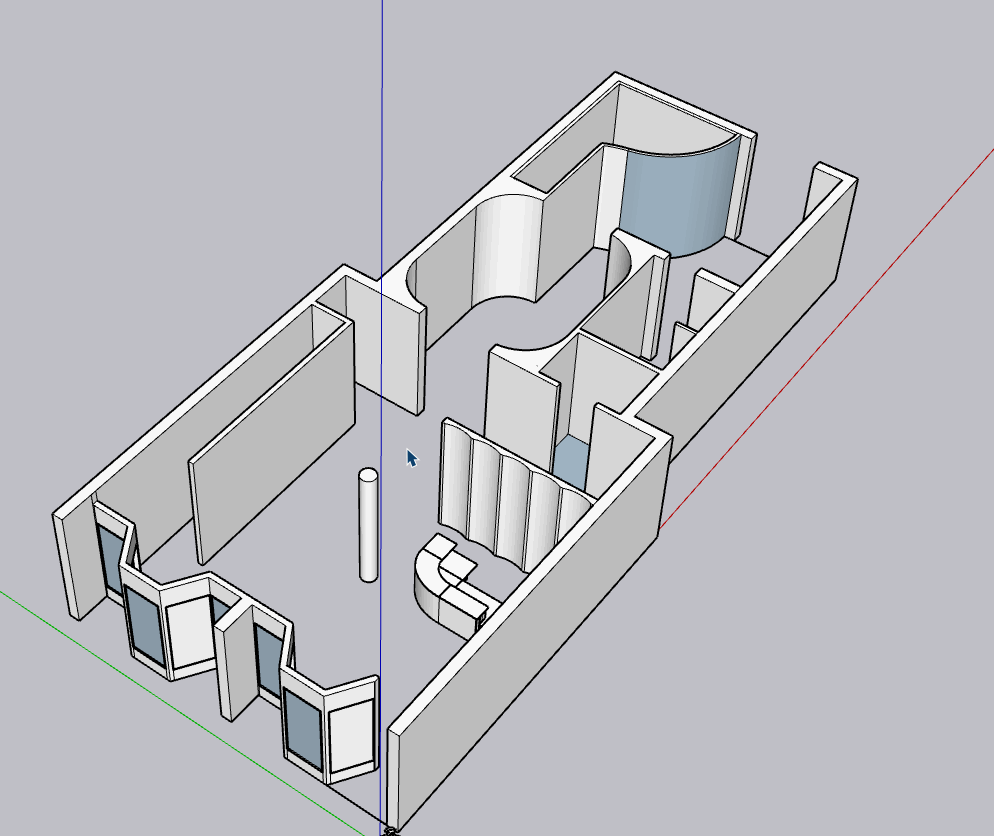

      My SketchUp model continues to glitch every time i move my cursor. My professor and I believe it has something to do with the amount of curved walls I have in my space. I used the "2-point arch" tool to create my curves, and think it is grabbing my geometry lines. What can i do to prevent this?

          @icorrea I don't think it has anything to do with the number of curves in your model. It's a fairly simple one. I agree with Rich. If you are having problems it's most likely the graphics card or its drivers. What version of SketchUp are you using?
          Share a screen shot of what you see. This is what I'm seeing. A few exposed back faces (blue) but no problem working in the model.
