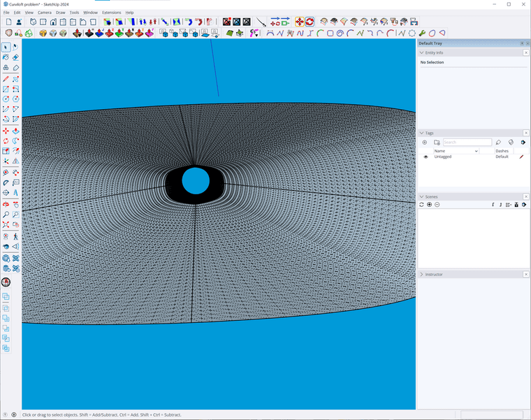

      So far, so good. But the precise shape is important. The result has this deformations (copied into 4 corners):
      In all 4 corners where the quarter portion is connected, there is a curl inward. The transition is from a perfect circle to a rounded rectangle with all angles bulging outward, there is no inward crease in the base shape:
      It still happens, whether I do it in quarters, or halves, or the whole shape at once. See the creases going inward where the quadrants meet. I have tried every combination of settings in the curviloft options. What am I doing wrong? Anyone know how to get a basic loft that follows the geometry, without adding the inflection inward?

        Easier investigate if you share the SKP file.
        • Mike AmosM Offline
          I thi nk extrusion tools might be better for this instance. I end up trying both as they can return distinctly different results but usually one OR the other will do the job.
          I have seen this issue many times.
          ALso, do all the arcs have the same number of segments or multiples thereof?

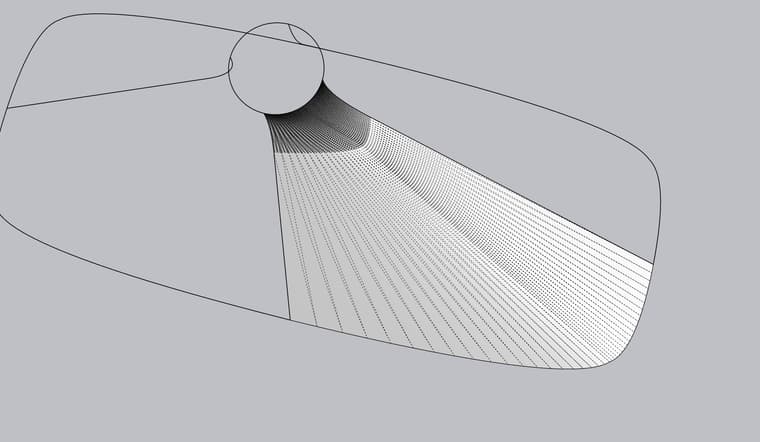

                    First I just extruded the base vertically. Second attempt I added a step.

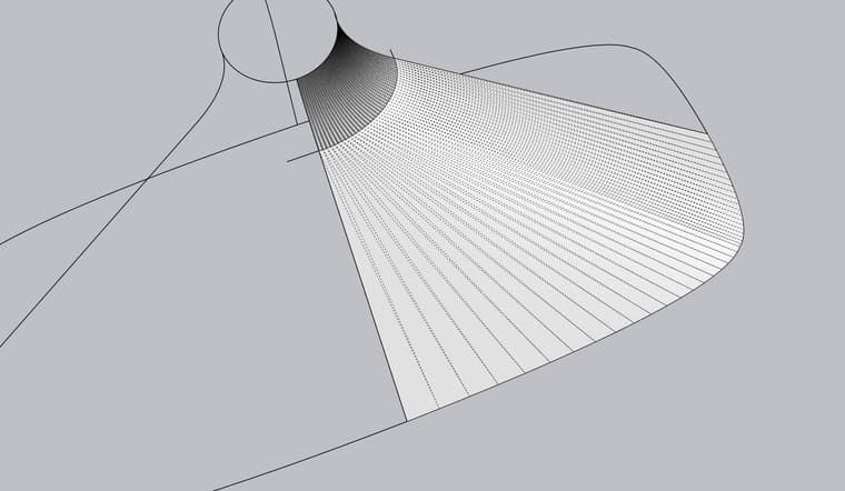

                    Copied the top arc and placed it as seen in the second image, scaled to fit and extruded. I think this is the money shot.

                        I think I've figured the workaround for Extension Tools "extrude edges by rails"
                        The trick to getting rid of artefacts at junctions seems to be:
                        1. With the top and bottom quarter-pie profiles, go to the end of each curve. Make sure the final segment is parallel to x or y axis. In other words, counter the default sketchup behaviour to place equal sized segments for a circle, with segments adjacent to axes at an angle. Make the end segments of profile curves are squared off instead.
                        2. Divide the long sections of the rails into many segments (I used 40).
                        Result:
