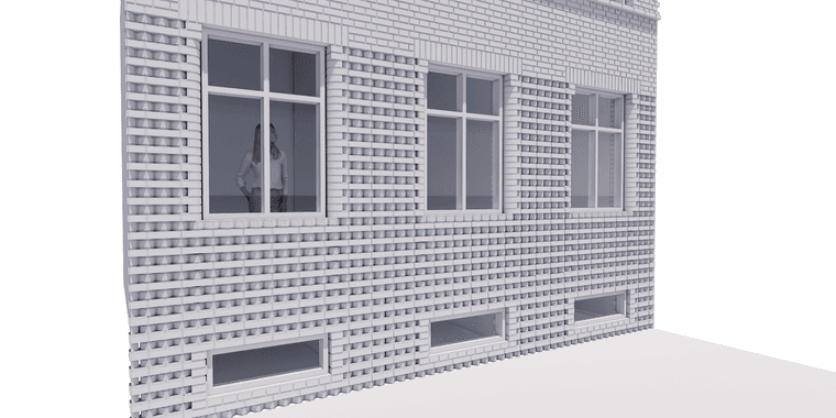

      I’m looking for a way to create a trustworthy looking brick wall.
      I have modelled a brick wall using several components, and I’m now looking for a way to texture it.
      I have found some random tools, that lets me select a random selection of already selected components, and then manually select materials to the selected components.
      What could be nice for this, would be a plugin that
      • let’s me select 3-10 different materials
      • assigns the material in a random order
      • to the selected components
      Or there might be an even better way to achieve what I’m looking for?
      Best regards
      Jorgensen

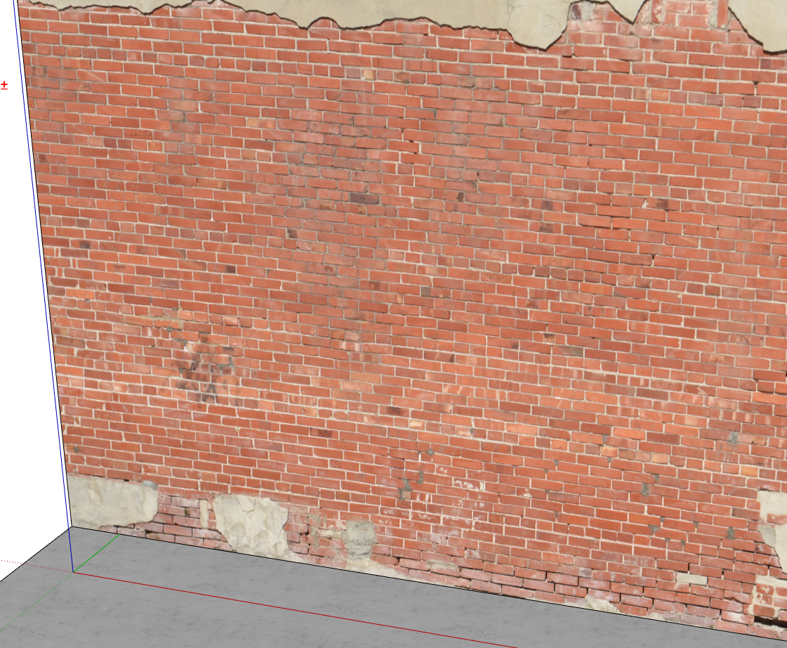

        You could create a bunch of brick textures if you want but I would skip making the brick components and then use a texture made from a photo of a large wall. This is from one of my brick textures. It's quite a bit larger than I show but I can pick out different sections of it as needed. Can't get any more "trustworthy" than that.

          Hi dave
          i totally agree - using a texture, gives the most "trustworthy" realistic result.
          the challenge is, that i'm experimenting with different kinds of brick details, so i don't think i can use a texture, as i normally would do.
