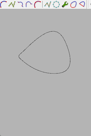

        @neverpoint
        Hi:
        Most of the spline commands can generate a face when they are closed:
        If this is not the case, select the spline and type in the Ruby console:
        spline=Sketchup.active_model.selection[0]
        # will return something like => #<Sketchup::Edge:0x000001a70b1968e8>
        face = spline.find_faces
        # will return something like => 1 (1 being the number of face(s) created
        or simply redraw a segment of the spline and the face will also be created.
        Regards
        DB
