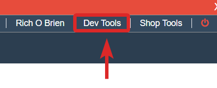

            Go here sketchucation.com
            Click Dev Tools
            Have a go getting it listed

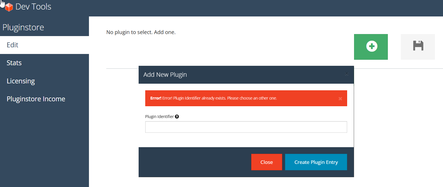

                Give it a name aka Plugin Identifier in this instance ViewportBuster

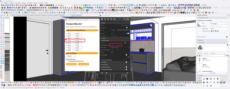

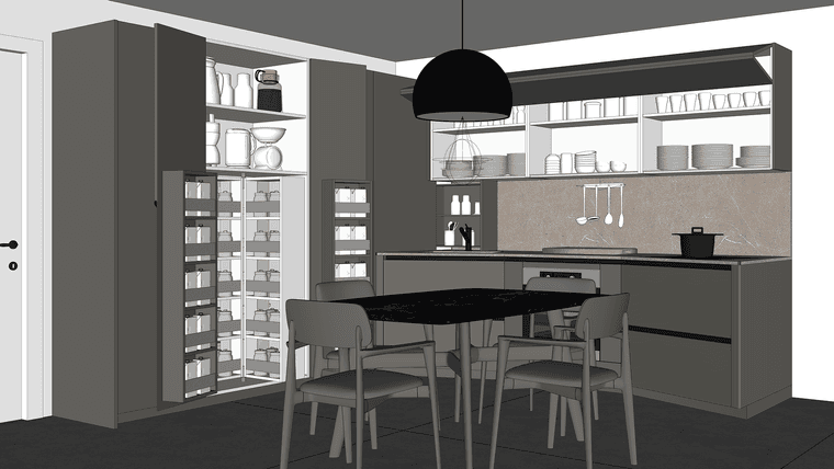

                  @HornOxx Congratulations on your plugin, I wanted to ask you something though. I have a widescreen monitor and I would like to understand if I can capture the images I see on the monitor, but when I try to increase the length of the capture, it still doesn't go beyond 16:9. Is there a solution? That would be even more fantastic.! Sketchup 2025![SketchUp_dhLwQGAoOj.png](/assets/uploads/files/1748525771610-sketchupviewport_4800x2700.png _dhlwqgaooj-resized.png)SketchUp_dhLwQGAoOj.png

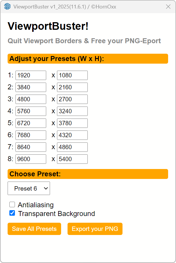

                    Yes, of course, there is a solution, and obviously I didn't make that clear enough 😊 No one has to work with my default settings; you can set your own prefered Preset-settings as you like.
                    I assume you exported the image using one of my preset settings, all of which are actually in HD aspect ratio πŸ˜‰ These are the settings I always prefer.
                    Now I've imitated your viewport proportions. Let's say you have approx. 2100px x 730px (you can see this when you use SkUp's native exporter).
                    You can now use these aspect-ratio-values from your given viewport in my plugin, for example as Preset 1 and Preset 2, and also save them so that they remain as consistent exortsettings for you.

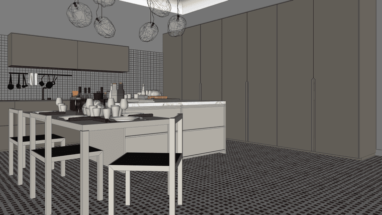

                    And just to check – ViewportBuster exports Preset 2 exactly as it should and even with the correct automated PNG naming :

                      @HornOxx "I can't do it, look, I tried to put in module 4 the total dimensions of the monitor which are the same ones also reported by V-Ray, but it keeps saving in 16:9 format."

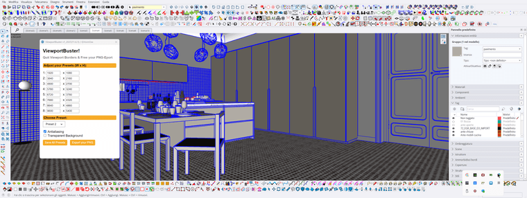

                        I am still unable to reproduce your issue – please see the screenshot of my retest with your values. The Viewportbuster is doing exactly what it should.

                          @HornOxx Thank you, you've been extremely helpful. I practically discovered that if I don't save the parameters, even if I go and change them manually and then export the image, it doesn't save the image with the correct parameters. If I save the parameters instead, it works. Anyway, I want to compliment you again because the utility is small but very, very useful, at least for me.

                            Yes, saving your own needed presets for having them available further on is the essential benefit from this tool 😜 and was my intention for making this tool (in a much easier version) about a year ago.
                            By the way, having easy access to standardized export settings is an underestimated point because it makes live so much easier in any downstream workflow such as layouting or so. And you don't have to care about your own sketchup setup anymore. You or even anyone else will be able now to reproduce your own absolute identical export results again and again any time you want.
                            Best, and I'm glad that everything is going well now.
                            Ps: don't forget to setup AND SAVE your remaining 7 possible presets 😜
                            Hitting the Save button saves ALL your done settings, not only W x H.
                            When you close sketchup and reopen it any time later, your ViewportBuster will then open with YOUR own presets...
