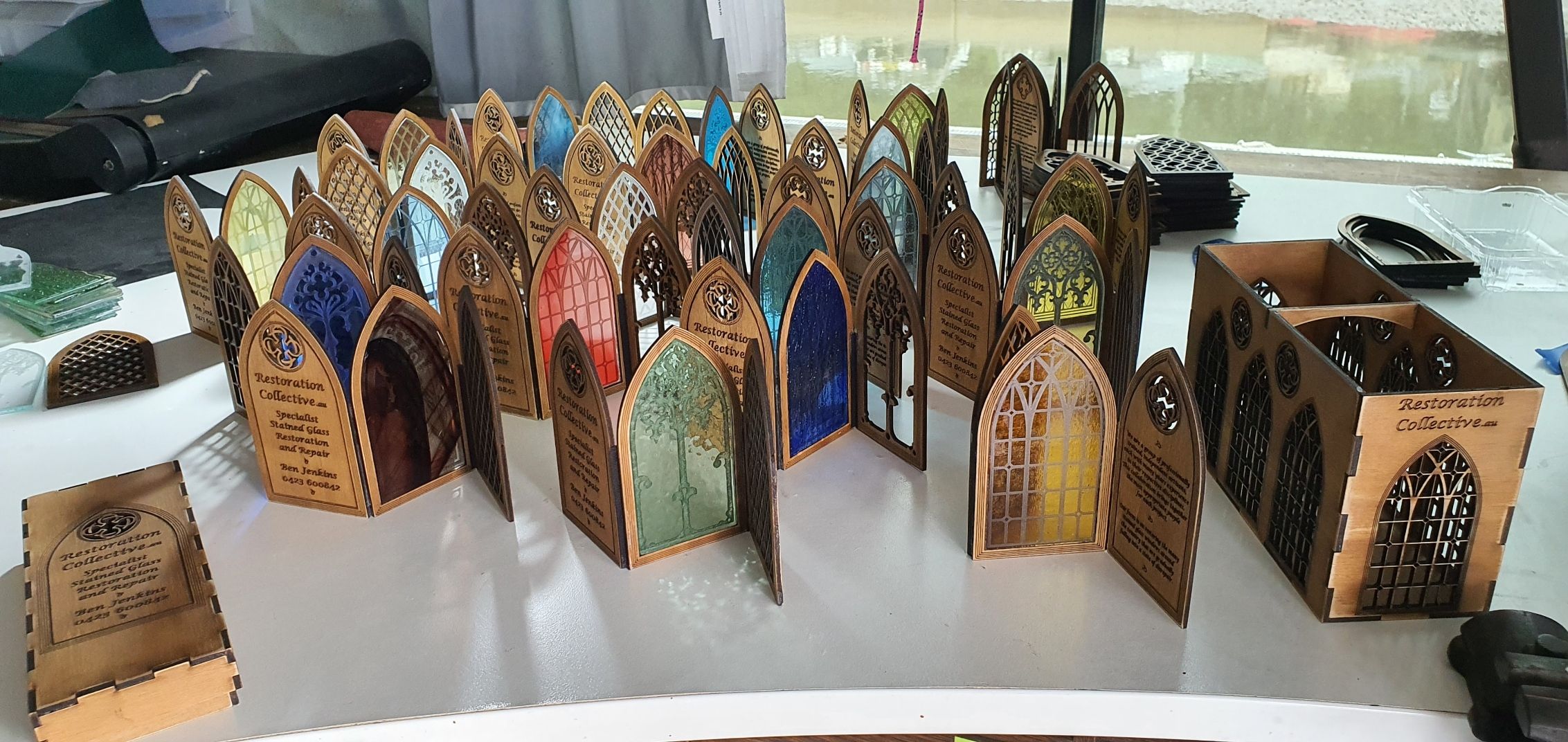

      A really simple example of how sketchup can be used to help design some promotional material.
      I've basically started with a gothic arch and an offset and worked from there. I've kept the two original outlines as the standard and used them to make everything else fit.
      I created the designs in sketchup and used Eneroth's .svg exporter to get the linework into Lightburn for the laser.
      These are some of he designs.
      I was able to use them for both cutting the wood and working with the glass paint.
      Then I designed a box to fit them in, it helped being able to use 3d models to work out how things fit together.
      You can see the complete box to hold 20 'cards' and its corresponding flat layout ready for the laser and my current thinking on a box for 10 with a hinged and sloped lid.
      I didn't find the need to model all the cutouts and engraving in sketchup, although I could have, since I had exported them all ready for the laser.
      So it became a simple case of put the parts together in Lightburn and set fire to everything.
      The current result being a finished set of 20 with traveling box.
