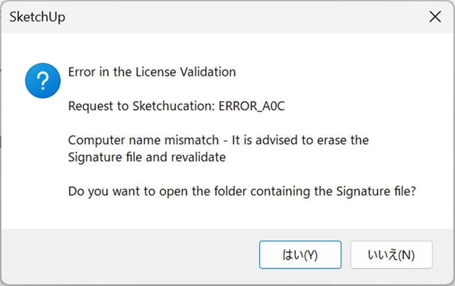

                          hello, I already used your tools, of course purchased license. But few days ago, i changed my computer account's name then, the license does not going. How can i doing?

                              Rich O Brien Moderator @megahits
                              @megahits said in SCFLicense: Extension Licensing on Sketchucation:
                              Error messages when activating?
                              Most likely, since you changed a devices name, the signature file will complain.
                              • Go to https://sketchucation.com/webshop/my-licences.php and release seats
                              • Open SketchUp
                              • Go to Extensions > Sketchucation > Global License Status and click License File Location
                              • Close SketchUp and in the Explorer delete the SCFLicenseSignature - DO NOT MODIFY OR DELETE.txt
                              • Open SketchUp and activate licenses.
                              Please make sure all devices are running Sketchucation Tools 4.4.1 and the most recent Libfredo. This enables online seat releasing at https://sketchucation.com/webshop/my-licences.php
                              Otherwise seats will be frozen.

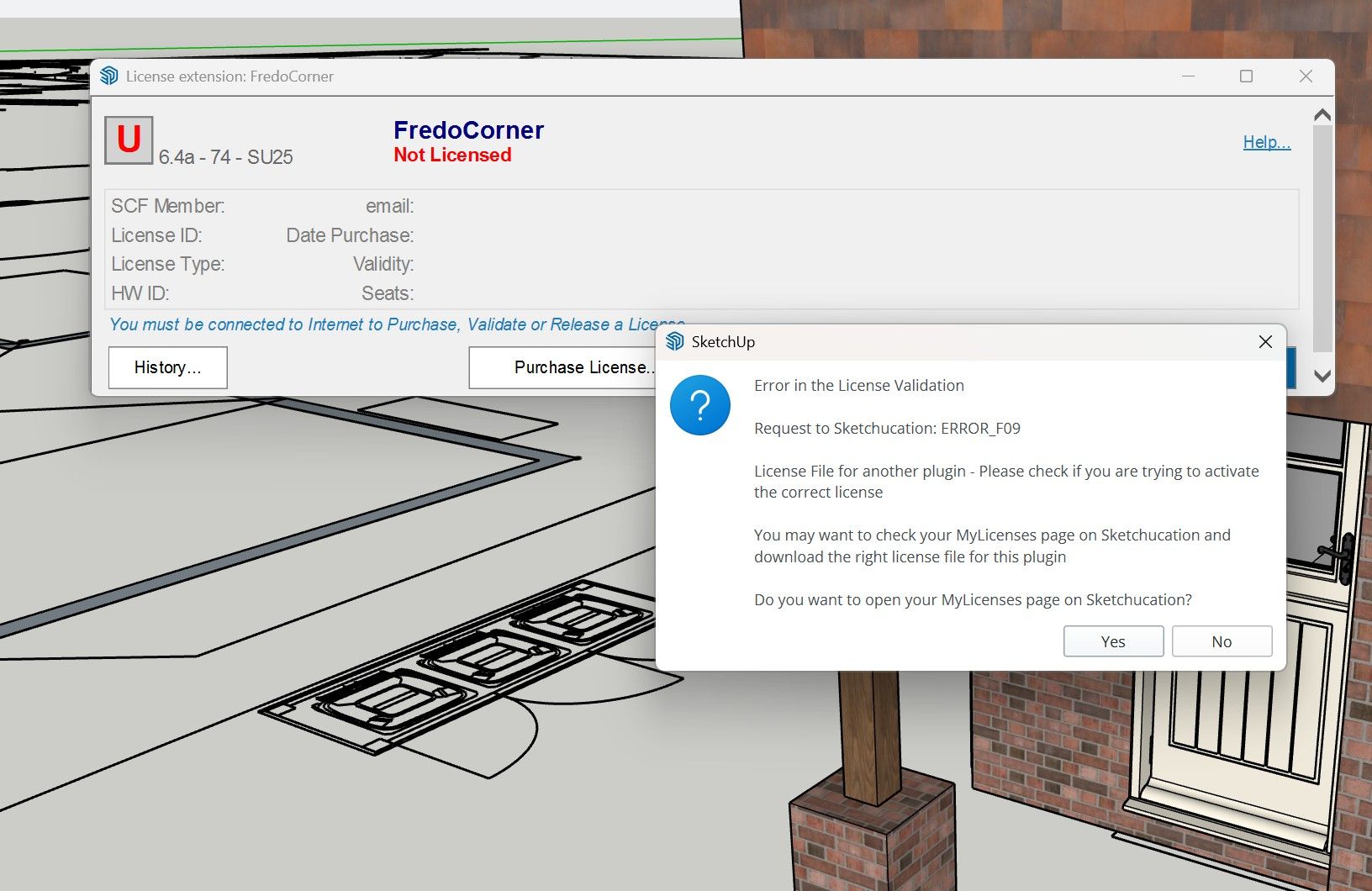

                                    Hello, error codes B03 and A04 keep appearing. I'll also send you the plugin version logs. Thank you for your help.
                                    Fredo6 Plugins Information on 2025-05-14 20:13:47 +0200
                                    • Platform: x64-mswin64_140 - Ruby: 2.7.7
                                    • Sketchup: 23.1.340
                                    • LibFredo6: v15.4a
                                    • LibFredo6 Binary loaded
                                    • Sketchucation ExtensionStore: 4.4.1
                                    • SCFLicense: v6.4a - 74
                                    • Fredo6 Plugins
                                      JointPushPull v4.9a
                                    • SCFLicense directory present
                                      Signature File: 2025-05-14 20:12:47 +0200
                                      Rich O Brien Moderator @Rémi Gaming
                                      @Rémi-Gaming said in SCFLicense: Extension Licensing on Sketchucation:
                                      Are you using the license for JPP at https://sketchucation.com/webshop/my-licences.php to activate?
                                      If your device name uses special characters please change it to use alphanumeric characters only.

                                        Yes, I bought the license on the site https://sketchucation.com. I also tried to change the name of my computer to Rémi8Gaming, but it didn't work.
                                          Rémi8Gaming
                                          é is a special character
                                          • R
                                            Rémi Gaming Newcomers
                                            Great, thank you very much, it works.
