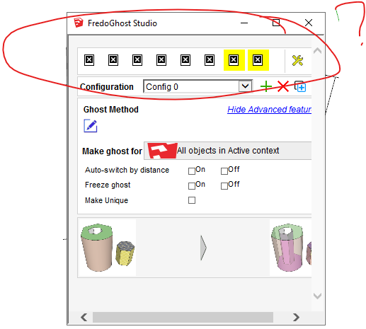

      Greetings,
      What has been wrong with the plugin - the only one fro Fredo6 - Ghost, there are no icon in a box setting?
      I have been using a Sketchucation Tools - could it be some relation to the issue?
      Many thanks in advance.
      https://i.postimg.cc/SKHZvL35/Annotation-2020-05-05-154309.png

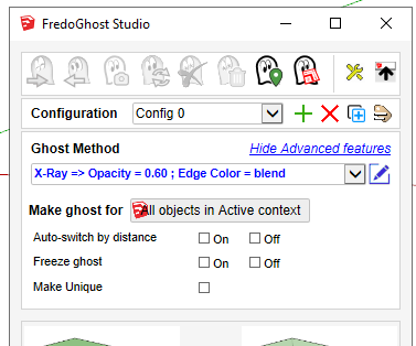

        This is what I see. It seems to be working fine. It was installed with Sketchucation Tools, too.
        Which version of FredoGhost do you have? Is LibFredo6 up to date?

            Indeed the icons should look like at the picture above.
            Sketchup 2020.1 has been installed with <run as admin< option.
            Fredo plugins and Library are the latest versions.
            That is why I am curious about the reason/culprit.
