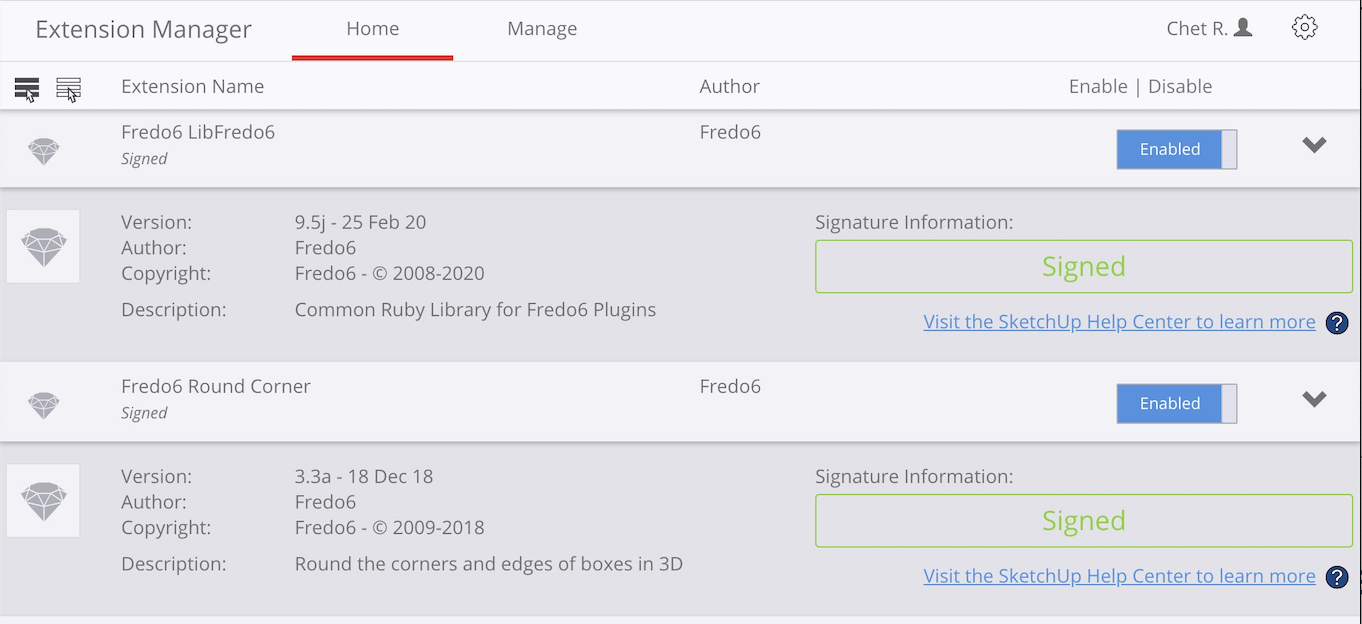

      I suspect that since RoundCorner hasn't been updated since the end of 2018 it might not be Catalina MAC friendly, even if it's v2020 compatible ?
      However, Fredo's newer tool FredoCorner is up to date v1.7d, and works much the same [and better]
      https://sketchucation.com/pluginstore?pln=FredoCorner
      Why not try that alternative ??

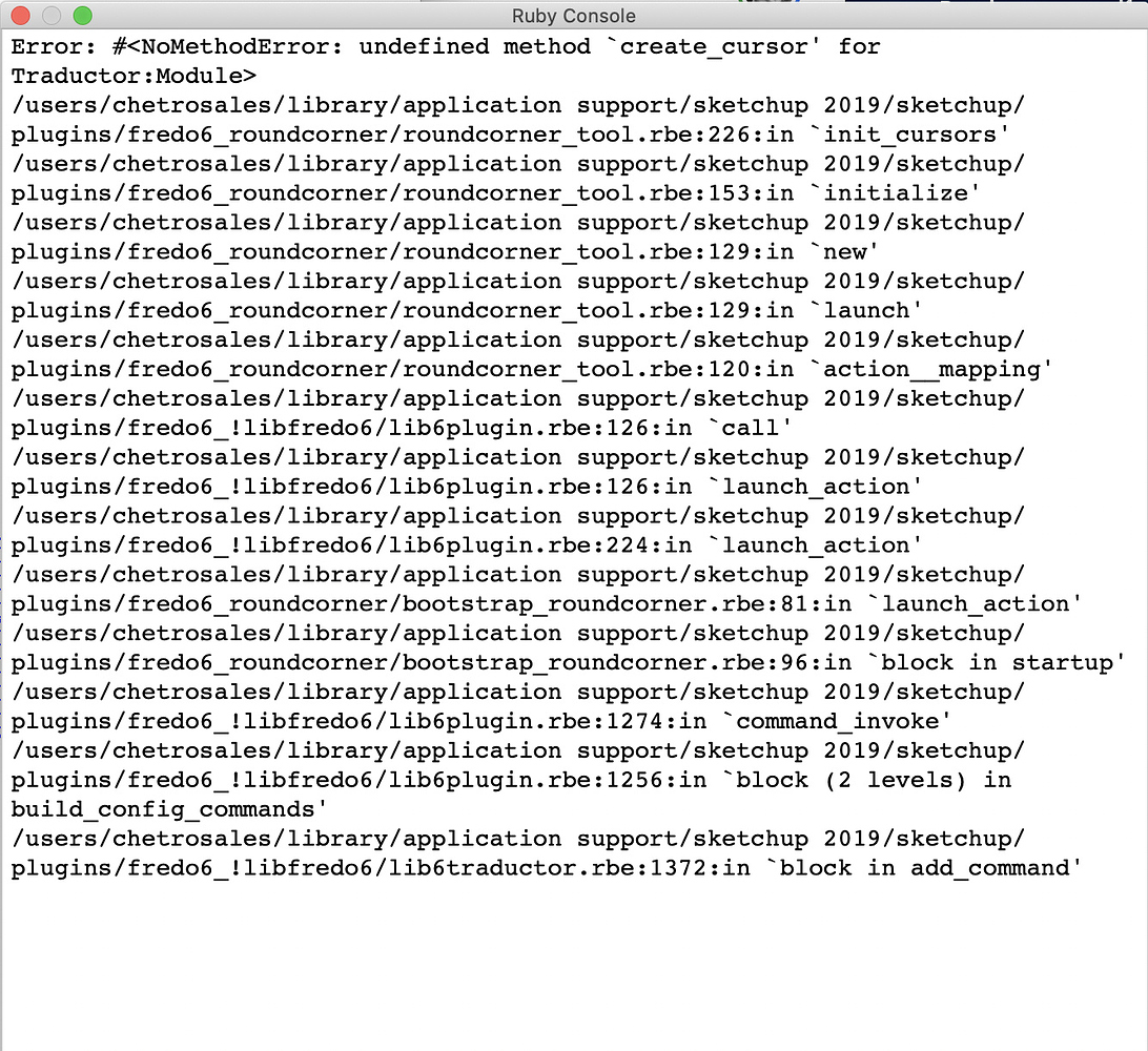

        The reason nothing is happening when you try to use the tool is that there's an error - see the Ruby Console message...
        Someone at sketchup.com asked if you had your MAC set up to be case-sensitive ?
        I don't think you confirmed...
        MACs should be case-insensitive, otherwise weird issues can happen...
        Google to see issues and fixes...

                I just tried FedoCorner and the 'same' thing happened... It looks like it is either not updated for Mac Catalina OS and/or the case-sensitive issue. I hope the folks at @Fredo6 (if they are listening) will address this issue for all the Mac users out there πŸ˜‰

                  Could you open the Ruby console and copy / paste the command below (then type Enter).
                  Dir[File.join(Sketchup.find_support_file("Plugins"), '*.rb')]
                  The result should be the list of .rb files in the Plugin directory.
                  Catalina has now been out for a while, and I have not heard of issues running my plugins. So there must be something special in your setup (or new trick from the folks at Apple...!)

                    • fredo6F
                      fredo6
                      Still, it would be good to understand why this prevents some 'rb' files to load.
                      In my plugins, the second-phase loading is managed from the Ruby code. Normally, all files are using the right text case. So somehow, I assume that the file system is case sensitive, at least for all Ruby methods.
                      However, I suspect that Dir[] returns all file path in lowercase and this may make some comparison and validation fail. Same for file.exist?, which may expect a lowercase file path.
                      Definitely, the setup of the Catalina system file seems to be the culprit, but I think this can be supported if we understand what is going on underneath at Ruby level.
